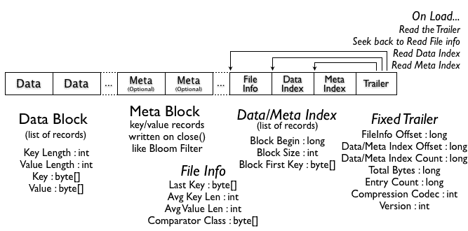

    In HBase 0.20, MapFile is replaced by HFile: a specific map file implementation for HBase. The idea is quite similar to MapFile, but it adds more features than just a plain key/value file. Features such as support for metadata and the index is now kept in the same file.
    The data blocks contain the actual key/values as a MapFile.  For each “block close operation” the first key is added to the index, and the index is written on HFile close.
    The HFile format also adds two extra “metadata” block types: Meta and FileInfo.  These two key/value blocks are written upon file close.
    The Meta block is designed to keep a large amount of data with its key as a String, while FileInfo is a simple Map preferred for small information with keys and values that are both byte-array. Regionserver’s StoreFile uses Meta-Blocks to store a Bloom Filter, and FileInfo for Max SequenceId, Major compaction key and Timerange info. This information is useful to avoid reading the file if there’s no chance that the key is present (Bloom Filter), if the file is too old (Max SequenceId) or if the file is too new (Timerange) to contain what we’re looking for.

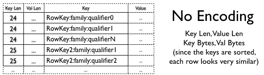

    Since keys are sorted and usually very similar, it is possible to design a better compression than what a general purpose algorithm can do.
    No Encoding

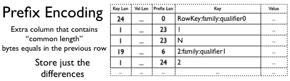

    Prefix Encoding
    The main idea of Prefix Encoding is to store the common prefix only once, since the rows are sorted and the beginning is typically the same.

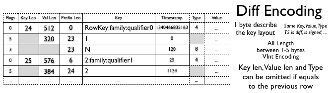

    Diff Encoding
    The Diff Encoding pushes this concept further. Instead of considering the key as an opaque sequence of bytes, the Diff Encoder splits each key field in order to compress each part in a better way. This being that the column family is stored once. If the key length, value length and type are the same as the row prior, the field is omitted. Also, for increased compression, the timestamp is stored is stored as a Diff from the previous one.
    Note that this feature is off by default since writing and scanning are slower but more data is cached. To enable this feature you can set DATA_BLOCK_ENCODING = PREFIX | DIFF | FAST_DIFF in the table info.
