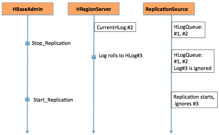

    Start/Stop Replication
    Start/Stop commands work as a kill switch. When stop_replication command is run at the HBase shell, it will change the value of /hbase/replication/state to false. It will stop all the replication source objects from reading the logs; but the existing read entries will be shipped. If a user uses the stop replication command,  the newly rolled logs will not be enqueued for replication. Similarly, issuing a start_replication command will start the replication from the current WAL (which may contain some previous transactions), and not from the time when the command was issued.
    Figure 1 explains the start-stop switch behavior, where the sequence of events flows in the direction of arrows.
