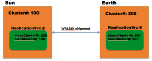

  2. Master-Master: In this mode, replication is sent across in both the directions, for different or same tables, i.e., both the clusters are acting both as master and slave. In the case that they are replicating the same table, one may think it may lead to a never ending loop, but this is avoided by setting the clusterId of a Mutation (Put/Delete) to the clusterId of the originating cluster. Figure 2 explains this by using two clusters, namely Sun, and Earth. In figure 2, we have two blocks representing the two HBase clusters. They have clusterId 100, and 200 respectively. Each of the clusters has an instance of ReplicationSource, corresponding to the slave cluster it wants to replicate to; it knows cluster #Ids of both the clusters.
Figure 2. Sun and Earth, two HBase clusters
Lets say cluster#Sun receives a fresh and valid mutation M on a table and column family which is scoped for replication in both the clusters. It will have a default clusterID (0L). The replication Source instance ReplicationSrc-E will set its cluster#Id equal to the originator id (100), and ships it to cluster#Earth. When cluster#Earth receives the mutation, it replays it and the mutation is saved in its WAL, as per the normal flow. The cluster#Id of the mutation is kept intact in this log file at cluster#Earth.The Replication source instance at cluster#Earth, (ReplicationSrc-S, will read the mutation and checks its cluster#ID with the slaveCluster# (100, equal to cluster#Sun). Since they are equal, it will skip this WALEdit entry.

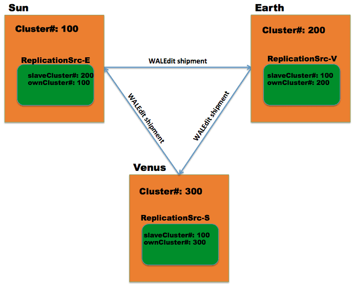

3. Cyclic: In this mode, there are more than two HBase clusters that are taking part in replication setup, and one can have various possible combinations of master-slave and master-master set up between any two clusters. The above two covers those cases well; one corner situation is when we have set up a cycle
Figure 3. A circular replication set up
Figure 3. shows a circular replication setup, where cluster#Sun is replicating to cluster#Earth, cluster#Earth is replicating to cluster#Venus, and cluster#Venus is replicating to cluster#Sun.
Let’s say cluster#Sun receives a fresh mutation M and is scoped to replication across all the above clusters. It will be replicated to cluster#Earth as explained above in the master master replication. The replication source instance at cluster#Earth, ReplicationSrc-V, will read the WAL and see the mutation and replicate it to cluster#Venus. The cluster#Id of the mutation is kept intact (as of cluster#Sun), at cluster#Venus. At this cluster, the replication source instance for cluster#Sun, ReplicationSrc-S, will see that the mutation has the same clusterId as its slaveCluster# (as of cluster#Sun), and therefore,  skip this from replicating.
