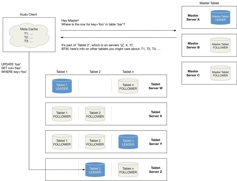

    Tables in Kudu are split into contiguous segments called tablets, and for fault-tolerance each tablet is replicated on multiple tablet servers. Kudu uses the Raft consensus algorithm to guarantee that changes made to a tablet are agreed upon by all of its replicas. At any given time, one replica is elected to be the leader while the others are followers. Any replica can service reads, but only the leader can accept writes. Raft keeps a replicated log of operations, and a write is only acknowledged once it has been persisted in the log by a majority of replicas. The replicated log is an abstract concept that is actually represented by the tablet’s write ahead logs (WAL). A tablet with N replicas (usually 3 or 5) can continue to accept writes with up to (N – 1) / 2 faulty replicas.
    Tablet discovery
    When a Kudu client is created it gets tablet location information from the master, and then talks to the server that serves the tablet directly. To optimise the read and write paths, clients keep a local cache of this information to prevent them from having to query the master for tablet location information on every request. Over time a client’s cache can become stale and when a write is sent to a tablet server that is no longer the leader for a tablet, it will be rejected. The client will then update its cache by querying the master to discover the new leader’s location.

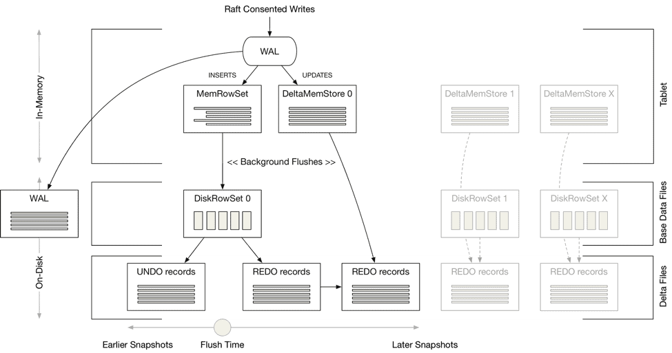

    Write operations are a set of rows to be inserted, updated, or deleted. An important consideration to note is Kudu enforces primary key uniqueness, and the primary key is the sole identifier by which rows can be changed. To enforce this constraint, Kudu must handle insert and update operations differently, and this influences how writes are handled by the tablet servers.
    Write path
    Each tablet in Kudu comprises of a write ahead log (WAL) and a number of RowSets, which are disjoint sets of rows that are held in-memory and (when flushed) on disk. Writes are committed to a tablet’s WAL and agreed upon according to Raft consensus, before being added to one of the tablet’s in-memory stores:
    Inserts are added to a tablet’s MemRowSet. In order to support MVCC in the MemRowSet, updates and deletes to recently inserted rows (i.e. new rows that have yet to be flushed to disk) are appended to the original row in the MemRowSet to form a list of REDO records. Readers need to apply the relevant REDO records to build the correct snapshot of a row based on the scanners given timestamp.
    When the MemRowSet fills up it is flushed to disk and becomes a DiskRowSet. In order to support MVCC for on-disk data, DiskRowSets are split into two different file types. The latest version of a row in the MemRowSet (i.e. the original insert with all of its REDO records applied) is written to a base data file. This is a columnar file format (much like Parquet) for fast, efficient read access and is what gives Kudu the ability to support analytical access patterns. The previous versions of a row that existed in the MemRowSet (i.e. the inverse of the REDO records) are written to a delta file as a set of UNDO records. Time travel reads can then apply the relevant UNDO records to build the correct snapshot of a row from an earlier point in time.
    Updating a columnar formatted data file that is encoded and compressed would require rewriting the entire file, and for this reason the base data files are considered immutable once flushed. In addition, the row key uniqueness constraint means that updates and deletes to the base records cannot be added to a tablet’s MemRowSet, and instead they are added to a separate in-memory store called a DeltaMemStore. Much like the MemRowSet, mutations are added to the DeltaMemStore as a set of REDO records, and when the DeltaMemStore fills up the REDO records are flushed to a delta file on disk. A separate DeltaMemStore exists for every DiskRowSet. To build the correct snapshot of a row, a reader must first find the row’s base record before applying the relevant UNDO or REDO records from the delta files.
