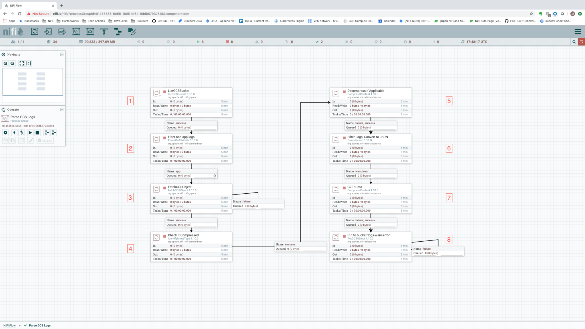

    Before diving into numbers and statistics, it is important to understand the use case. An ideal use case is one that is realistic yet simple enough that it can be explained concisely.

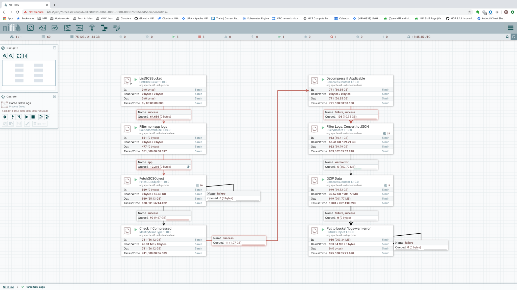

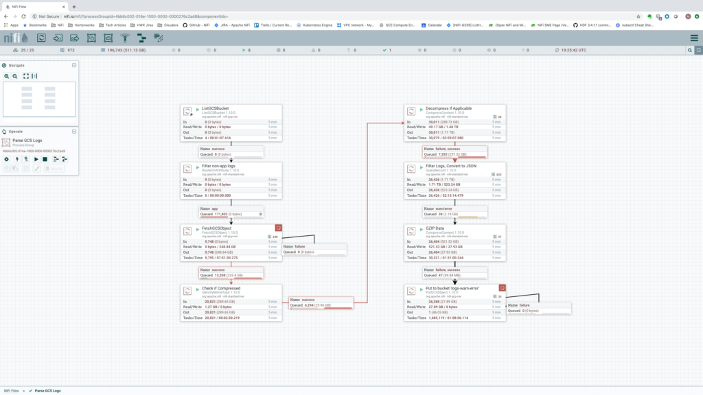

    The screenshot below illustrates such a use case. Each of the Processors is denoted with a number: 1 through 8. A walk-through of the use case, which follows, references these Processor numbers in order to describe how each step is accomplished in the dataflow.
    An ideal use case
    The use case that we present here is as follows:
    1. There exists a Bucket in Google Compute Storage (GCS). This bucket contains about 1.5 TB worth of NiFi log data, in addition to other, unrelated data that should be ignored.
    2. NiFi is to monitor this bucket [Processor 1]. When data lands in the bucket, NiFi is to pull the data if its filename contains “nifi-app”. [Processors 2, 3]
    3. The data may or may not be compressed. This must be detected for each incoming log file [Processor 4]. If it is compressed, it must be decompressed [Processor 5].
    4. Filter out any log messages except those that have a log level of “WARN” or “ERROR” [Processor 6]. If any Exception was included in the log message, that exception must also be retained. Also note that some log messages may be multi-line log messages.
    5. Convert the log messages into JSON [Processor 6].
    6. Compress the JSON (regardless of whether or not the original incoming data was compressed) [Processor 7].
    7. Finally, deliver the WARN and ERROR level log messages (in compressed JSON format), along with any stack traces, to a second GCS Bucket [Processor 8]. If there is any failure to push the data to GCS, the data is to be retried until it completes.
    This is a very common use case for NiFi. Monitor for new data, retrieve it when available, make routing decisions on it, filter the data, transform it, and finally push the data to its final destinations.
    Note the icon on the connection between the RouteOnAttribute Processor [Processor 2] and FetchGCSObject [Processor 3]. This icon indicates that data is being load-balanced across the cluster. Because GCS Buckets do not offer a queuing mechanism, it’s up to NiFi to make pulling the data cluster-friendly. We do this by performing the listing on a single node only (the Primary Node). We then distribute that listing across the cluster, and allow all nodes in the cluster to pull from GCS concurrently. This gives us tremendous throughput and avoids having to shuffle the data around between nodes in the cluster.
    Note also that we want to ensure that the data contains a good mix of WARN and ERROR messages and not just INFO level messages, because most dataflows do not filter out the vast majority of their data at the start. To this end, we caused the NiFi instances that were generating the logs to constantly error by intentionally misconfiguring some of the Processors. This resulted in about 20-30% of the log messages being warnings or errors and containing stack traces. The average message size is about 250 bytes.

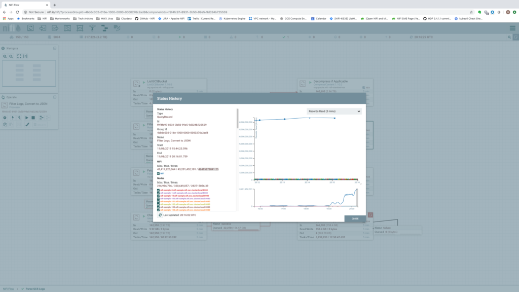

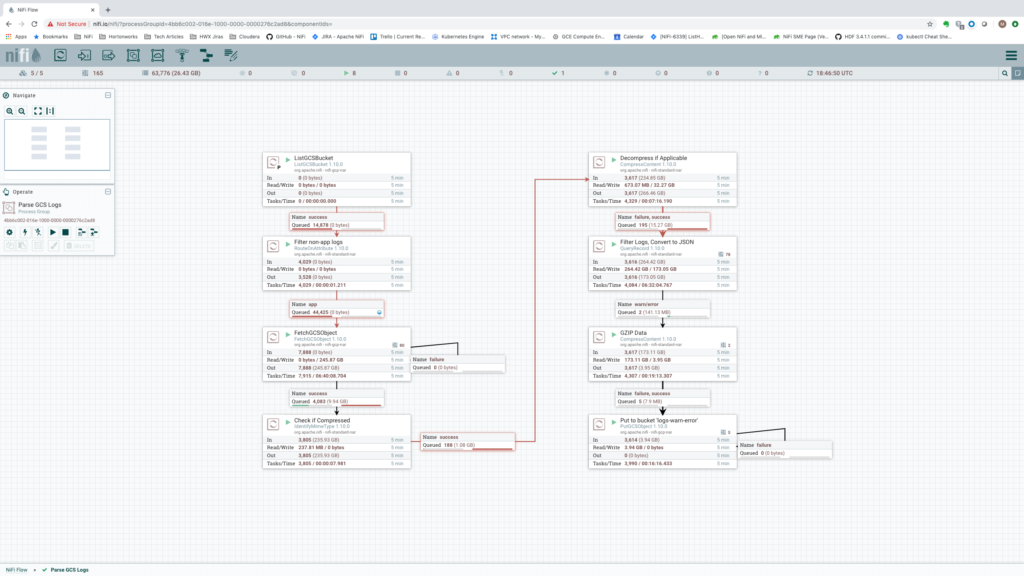

    Looking at these metrics, we can see how NiFi performs on this dataflow given a few different sized clusters. First, we will look at a single node:
    Single node cluster
    Here, we can see that the single node processed 56.41 GB of incoming data. This is over a 5 minute time window. If we divide that number by 300 seconds, we get 0.18803 GB/second, or about about 192.5 MB/sec. Looking at the Status History, we can get a feel for the number of Records (log messages) per second:

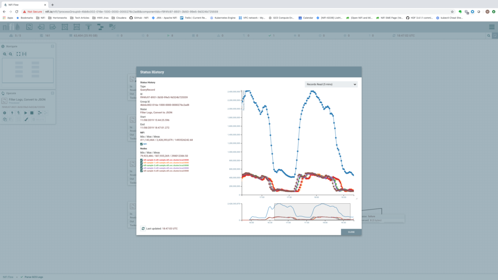

    Status History
    Here, we see that on average the single node processed 283,727,739 records per 5 minutes, or a little over 946,000 records per second. This is just shy of a million events per second – not shabby for a single node!

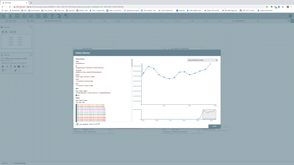

    5-node cluster
    Incoming data rate is now at 264.42 GB per five minutes (0.8814 GB/sec). In terms of records per second, we see an average of about 1.493 billion records per five minutes, or about 4.97 million records per second:
    An average of about 1.493 billion records per five minutes

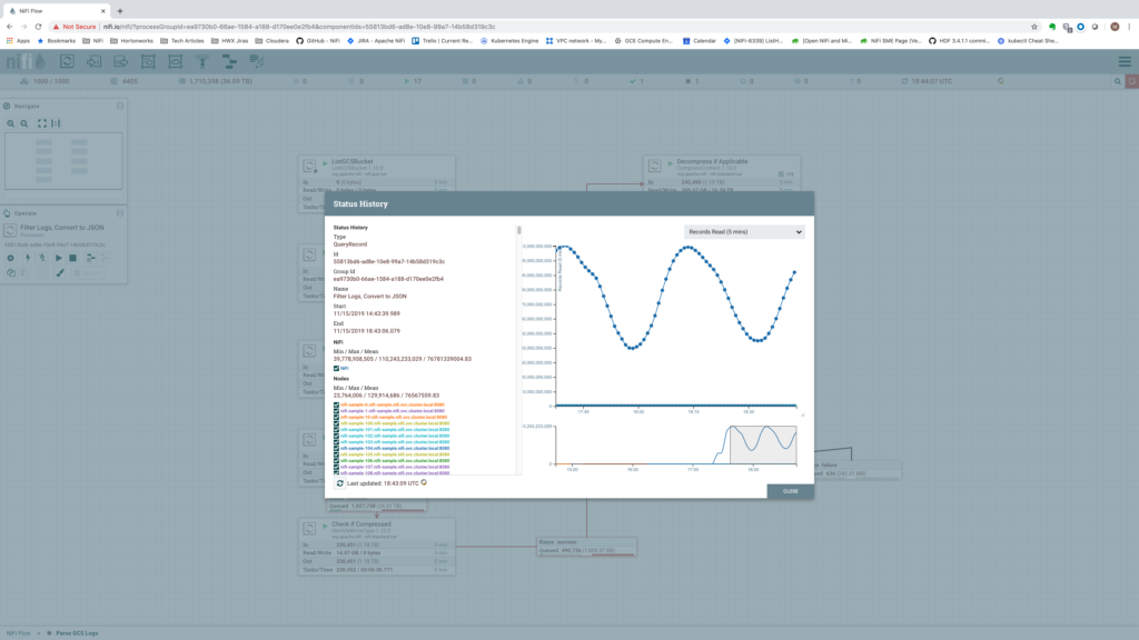

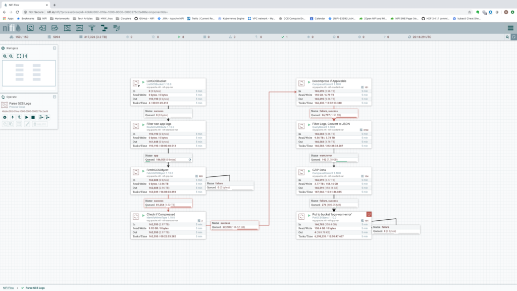

    Scaling this out further, we can observe the performance achievable with a 25-node cluster:

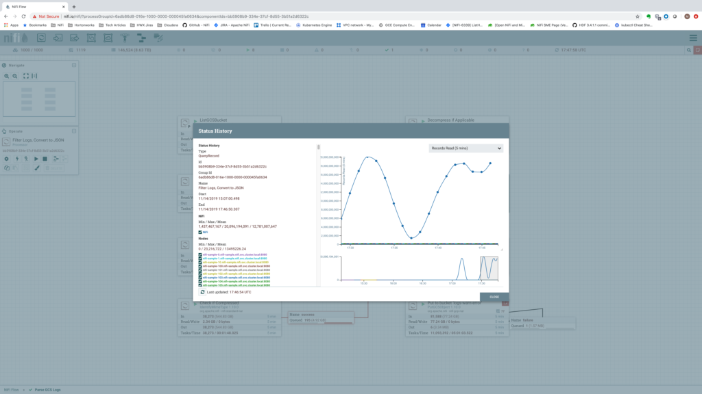

    25-node cluster
    We see an incoming data rate of a whopping 1.71 TB per 5 minutes, or 5.8 GB/sec. In terms of records per second, we show:
    Rates per second
    That’s a data rate of over 7.82 billion records per five minutes, or just north of 26 million events per second (or 2.25 trillion events per day). For a 25-node cluster, this equates to slightly over 1 million records/second per node.
    The astute reader may note the stark variation in the number of Records Read over time as we look at the Status History. This is best explained by the variation in the data. When processing files that contain very few errors, we see a huge number of records per second. When processing messages that contain stack traces (which are much larger and require more processing), we see a lower number of records per second. This is also evidenced by comparing these stats to those of the Records Written stats:

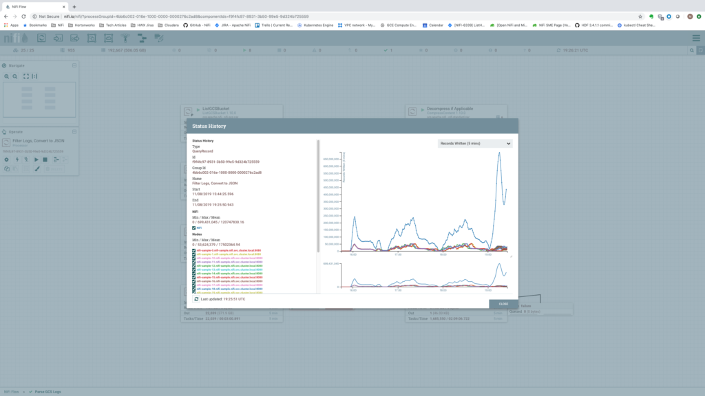

    Here, we see that as the number of Records Read decreases, the number of Records Written increases and vice versa. For this reason, we make sure that when we observe the statistics, we only consider time periods that include processing both small messages and large messages. To achieve this, we select time windows where the number of Records Read reaches a high point as well as a low point. We then consider the average number of Records Read over this time period.

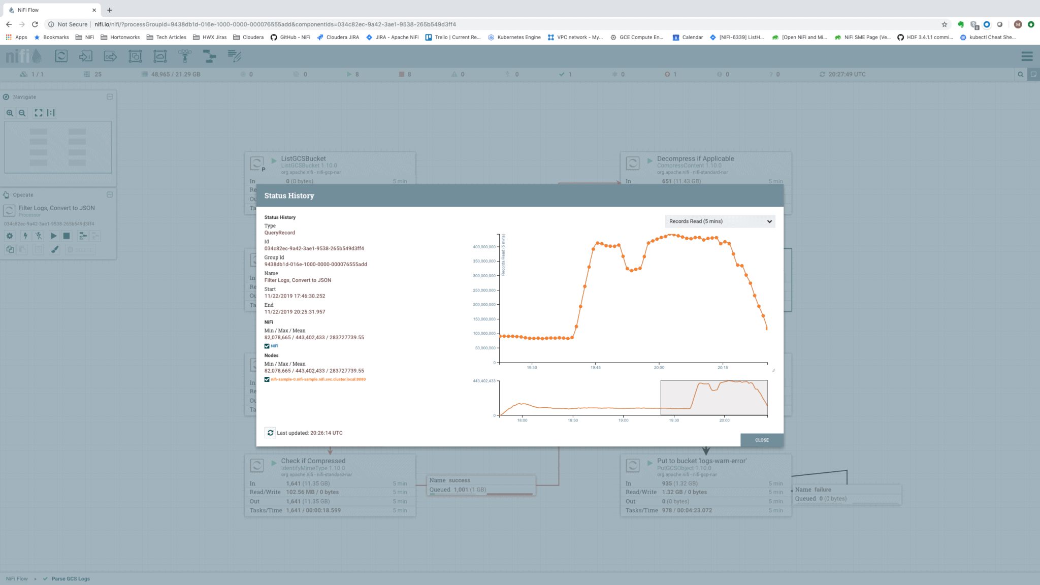

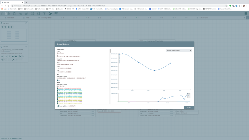

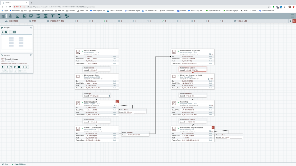

    To find out, we increased the cluster from 25 nodes to 100 nodes and then to 150 nodes. The results obtained for the 150-node cluster are shown here:
    Increase to 100 then 150 nodes
    Results of 150-node cluster
    Here, NiFi handles the data at an impressive rate of 9.56 TB (42.4 billion messages) per 5 minutes, or 32.6 GB/sec (141.3 million events per second). That equates to 2.75 PB (12.2 trillion events) per day! All with granular provenance information that tracks and displays every event that occurs to the data. When and where the data was received; how it was transformed; and when, where, and exactly what was sent elsewhere.

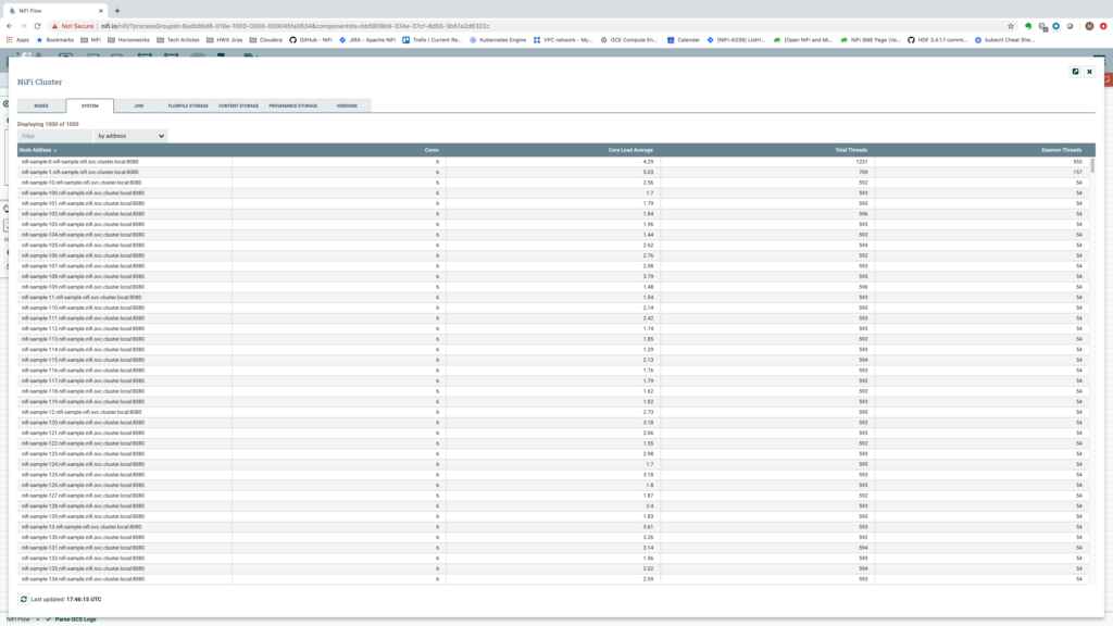

    Because we have such few cores, we also decreased the number of threads that we provided NiFi for running the flow. We can see that the nodes were not utilized too heavily, with the one-minute load average generally ranging from 2 to 4 on a 6-core VM:
