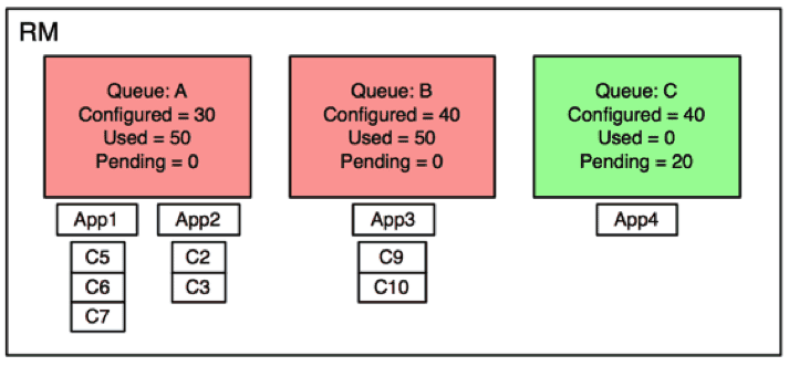

    We will now explain how preemption works in practice taking an example situation occurring in a Hadoop YARN cluster. Below is an example queue state in a cluster:
    Let’s say that we have 3 queues in the cluster with 4 applications running. Queues A and B have already used resources more than their configured minimum capacities. Queue-C is under satisfied and asking for more resources. Two applications are running in queue-A and one in each of queues B and C.
    We now describe the steps involved in the preemption process that tries to balance back the resource utilization across queues over time.
    Preemption Step #1: Get containers to-be-preempted from over-used queues
    The PreemptionMonitor checks queues’ status every X seconds, and figures out how many resources need to be taken back from each queue / application so as to fulfil needs of under-satisfied queues. As a result, it arrives at a list of containers to be preempted, as demonstrated below:
    For example, containers C5, C6, C7 from App1 and containers C2 and C3 from App2 are marked to-be-preempted. We will explore internal algorithms of how we select containers to be preempted in a separate detailed post shortly.

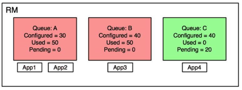

    Preemption Step #2: Notifying ApplicationMasters so that they can take actions
    Instead of killing thus-marked containers immediately to free resources, PreemptionMonitor inside the ResourceManager notifies ApplicationMasters (AM) so that AMs can take advanced actions before ResourceManager itself commits a hard decision. More details on what information AMs obtain and how they can act on it is described in the section “Impact of preemption on applications” below. This is a way for ApplicationMasters to do a second level pass (similar to scheduling) on what containers for the right set of resources to free up.

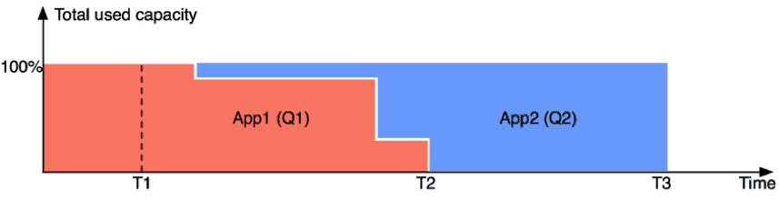

    We now demonstrate the advantages of preemption.The following example scenario should give you an intuitive understanding about how preemption can achieve a balance between elasticity (and making use of fallow resources) and application SLAs.
    Consider a simple case. Queues Q1 and Q2 have configured minimum capacity of 50%, and each of them have exactly one application running – App1 in Q1 and App2 in Q2. App1 starts running first, it occupies all the resources in the cluster (elasticity). Let’s say that while App1 is running at the full cluster capacity, a user submits App2 to queue Q2.
    The following is the timeline of the above events:
    • App1 starts running at time 0
    • T1: Time of App2’s submission
    • T2: Time when App1 can complete
    • T3: Time when App2 can complete
    When preemption is not enabled

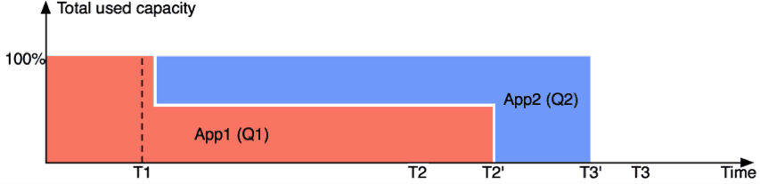

    When preemption is enabled
    With preemption enabled, ResourceManager will start preempting resources in a short time after App2 gets submitted, irrespective of whether App1 voluntarily releases containers or not. Apps in Q1 and Q2 will now share cluster-resources, each of them will get 50% of cluster resource, just as they were originally promised via minimum configured capacities. T2’ is the new time at which App1 completes in this setup, T3’ is the new time App2 gets completed.
     After preemption is enabled, App2 usually finishes faster (than when preemption was not enabled) – T3’ < T3. It is possible though that App1 now finishes slower – T2’ > T2. This is acceptable though given App1 originally got much more resources than was originally guaranteed. This way the system achieves a balance between using barren capacity and promising reasonable SLAs to new applications.

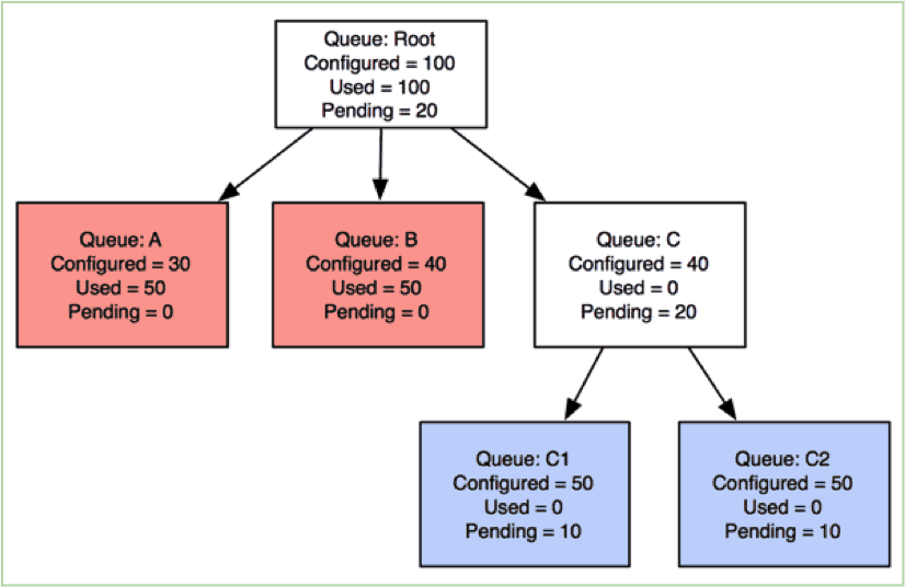

    Preemption across a hierarchy of queues
     So far, we have only talked about how preemption works across two queues at the same level. CapacityScheduler also supports the notion of a hierarchy of queues. Let’s see how preemption works in this context with an example.
    hierarchy of queues
    Queues C1 and C2 are under-satisfied and start to ask for reclaiming their originally promised resources back. Queues A/B are over-allocated. In this case, PreemptionMonitor will preempt containers in queues A and B so that the next scheduling cycle can allocate the freed-up resources to applications in queues C1 and C2.
    This way, preemption works in conjunction with the scheduling flow to make sure that resources freed up at any level in the hierarchy are given back to the right queues in the right level.
