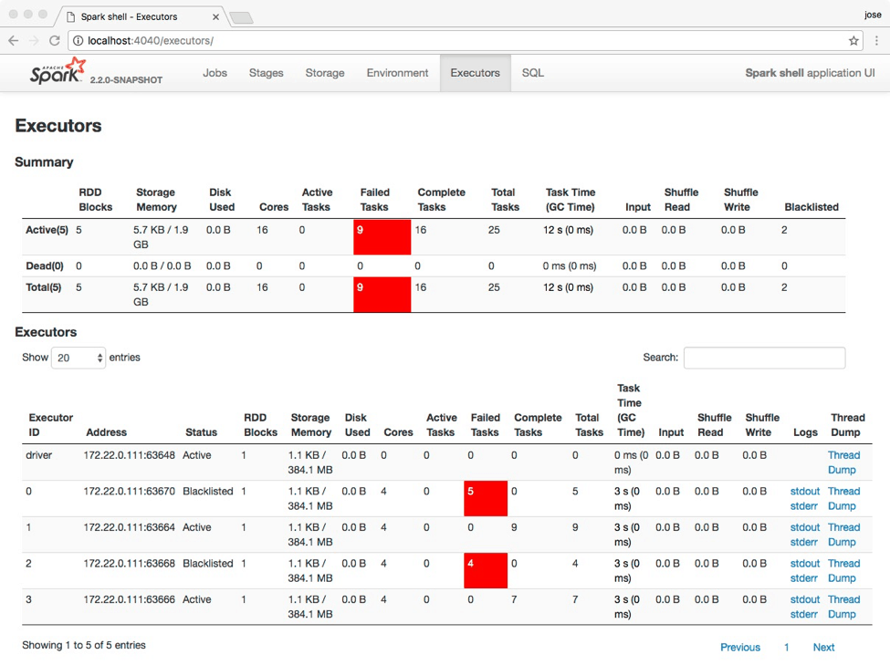

    Starting in Apache Spark 2.2 and Cloudera’s release of Apache Spark 2.1, the Apache Spark Web UI is able to communicate the “blacklisted” state to an end user. The scheduler also prints log messages when the blacklist is updated, and when a scheduling decision takes the contents of the blacklist into consideration. The screenshot below demonstrates this feature.
    Spark application UI demonstrating the new “blacklisted” state in the Summary and Executors views.

    4. After encountering the failure repeatedly, the driver decides that this executor and/or this node is unreliable. The driver removes the executor or node from the pool of available compute resources, and retries the task somewhere else. It likely succeeds and the user’s job continues transparently.
    We’re replaced an application failure with an error that is recovered transparently to the user.
