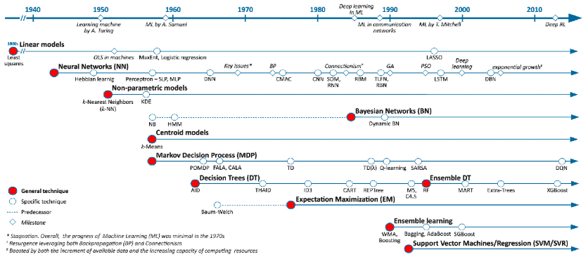

    Photo Source: Semanticscholar.org
    Perhaps not so coincidentally, the same period saw the rise of Big Data, carrying with it increased distributed data storage and distributed computing capabilities made popular by the Hadoop ecosystem. That said, and with a few exceptions (ex:Spark),  machine learning and Big Data have largely evolved independently, despite that…

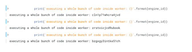

    Code (git available here ):
    import cdsw worker_code = ''' import os engine_id = os.environ.get('CDSW_ENGINE_ID') print('executing a whole bunch of code inside worker: {}'.format(engine_id)) ''' workers = cdsw.launch_workers(n=2, cpu=1, memory=1, code=worker_code)
    Result:

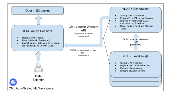

    The software architecture is presented in the diagram below:
    CML essentially launches a Kubernetes container-based cluster on-demand. Once the work is completed, the cluster is shut down and the resources are released.

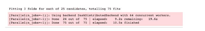

    Result :

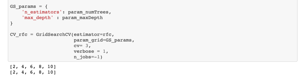

    In the example above, I am using DASK to train a Random Forest classifier, within a pipeline containing a grid search and cross-validation.
    pipeline configuration :
    from sklearn.model_selection import GridSearchCV
    from sklearn.ensemble import RandomForestClassifier
    # ### parameters for grid search
    param_numTrees = list(range(2,12,2))
    print(param_numTrees)
    param_maxDepth = list(range(2,12,2))
    print(param_maxDepth)
    rfc = RandomForestClassifier(random_state=10, n_jobs=-1)
    GS_params = {
        'n_estimators': param_numTrees,
        'max_depth' : param_maxDepth
    CV_rfc = GridSearchCV(estimator=rfc,
                          param_grid=GS_params,
                          cv= 3,
                          verbose = 1,
                          n_jobs=-1)
    Result :

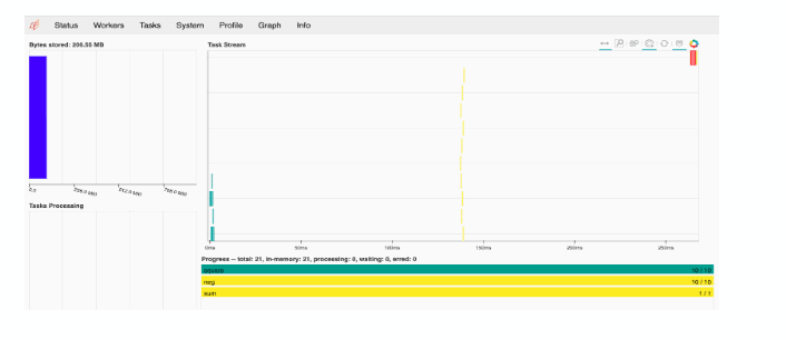

    Dask Dashboard
    Dask Dashboard

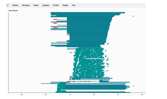

    DASK provides an interesting Dashboard where we can peek into the progress of execution of the training.
    Below:the DAG for the SKLearn training

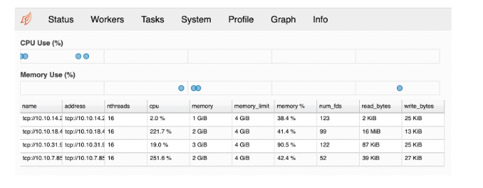

    We can also look at the current load of the cluster.
