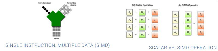

    Vectorization is the process of converting an algorithm from operating on a single value at a time to operating on a set of values at one time. Modern CPUs provide direct support for vector operations where a single instruction is applied to process multiple data points (SIMD).
    The figure above shows a simple example of addition of two sets of values using scalar as well as vector instructions.
    For example, a CPU which supports the AVX-512 instruction set provides 512-bit registers that can hold up to sixteen 32-bit values and do simple operations like addition in one instruction when compared to doing the same calculation in 16 scalar instructions. In this example, a vectorized execution will run 16 times faster than a scalar execution.

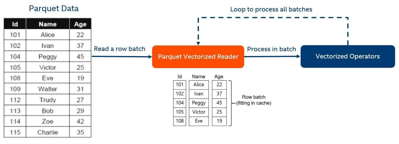

    Parquet Vectorized Reader
    Apache Parquet is a widely used columnar file format in big data ecosystems. However, the Parquet file format doesn’t provide a vectorized reader for Hive. This means that even when vectorization is turned on for your cluster, all the map tasks that read Parquet data process the data one row at a time. So queries using Parquet tables miss out on the performance gains of vectorized query execution. To improve this, Cloudera and Intel collaborated closely to introduce Hive Parquet Vectorization in HIVE-14826. The Parquet vectorized reader returns column batches of rows instead of one row at a time. The column batch can be passed to the operator tree without any intermediate conversion. Implementing the vectorized parquet reader on the Hive side instead of in the Parquet library further improves performance by avoiding an extra memory copy action to create the batches. This feature is available in Cloudera’s distribution of Apache Hive from CDH 6.0 onwards.

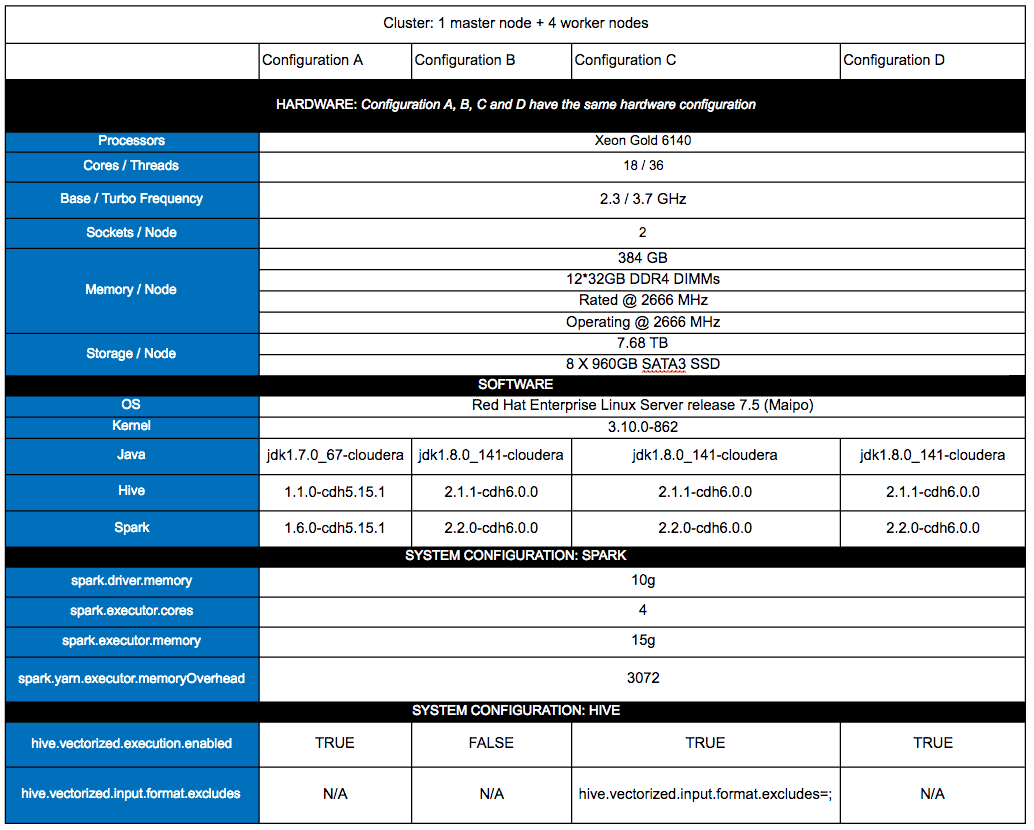

    We evaluated Parquet vectorization performance on a 4-node Skylake cluster (Xeon Gold 6140) with Hive on Spark. The workload run was TPC-DS on 3TB data scale. We used both CDH 5.15.1 and CDH 6.0 to get a comparison performance of different versions of CDH. Below are the hardware and software configurations we used:
    Performance Results
    Configuration A is the cluster which runs the baseline using CDH 5.15.1 which does not include the Parquet vectorization feature. Configuration B is the cluster where CDH 6.0 is installed with default set of configurations which disables Parquet vectorization. Configuration C is the cluster where CDH 6.0 is installed and the Parquet vectorization feature is enabled. We ran 55 queries from the TPC-DS workload.

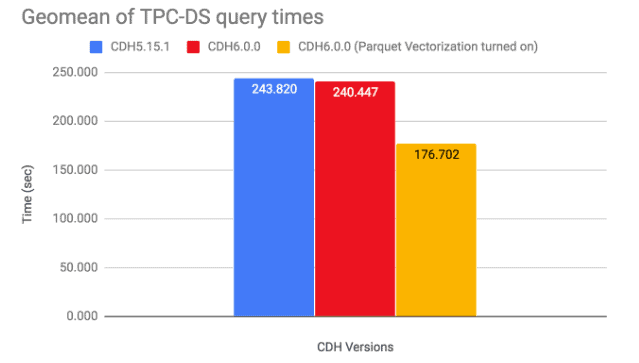

    We saw significant performance improvements from this feature. The geomean query time of all the queries was improved from 243.82 seconds in CDH 5.15.1 seconds to 176.70 seconds using Parquet vectorization in CDH 6.0, which is a 1.36x performance gain over CDH 5.15.1.
    Geomean of TPC-DS query times

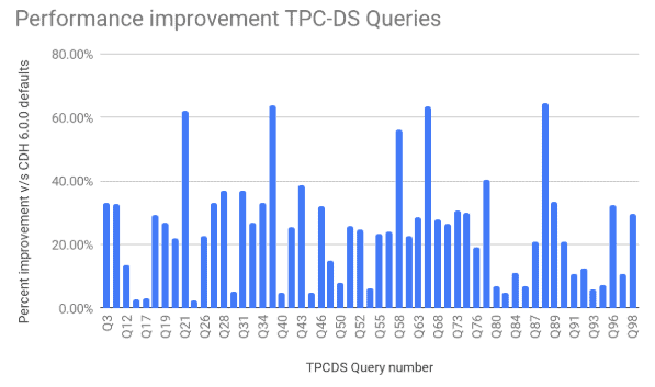

    The following figure shows the percentage improvement in run times of various TPC-DS queries compared to CDH 6.0 defaults (which disables parquet vectorization). Five queries (q21, q39, q58, q66, q88) show over a 50% performance gain while many of the rest of the queries show between 20% to 40% performance gain in runtime.
    Performance improvement TPC-DS queries
