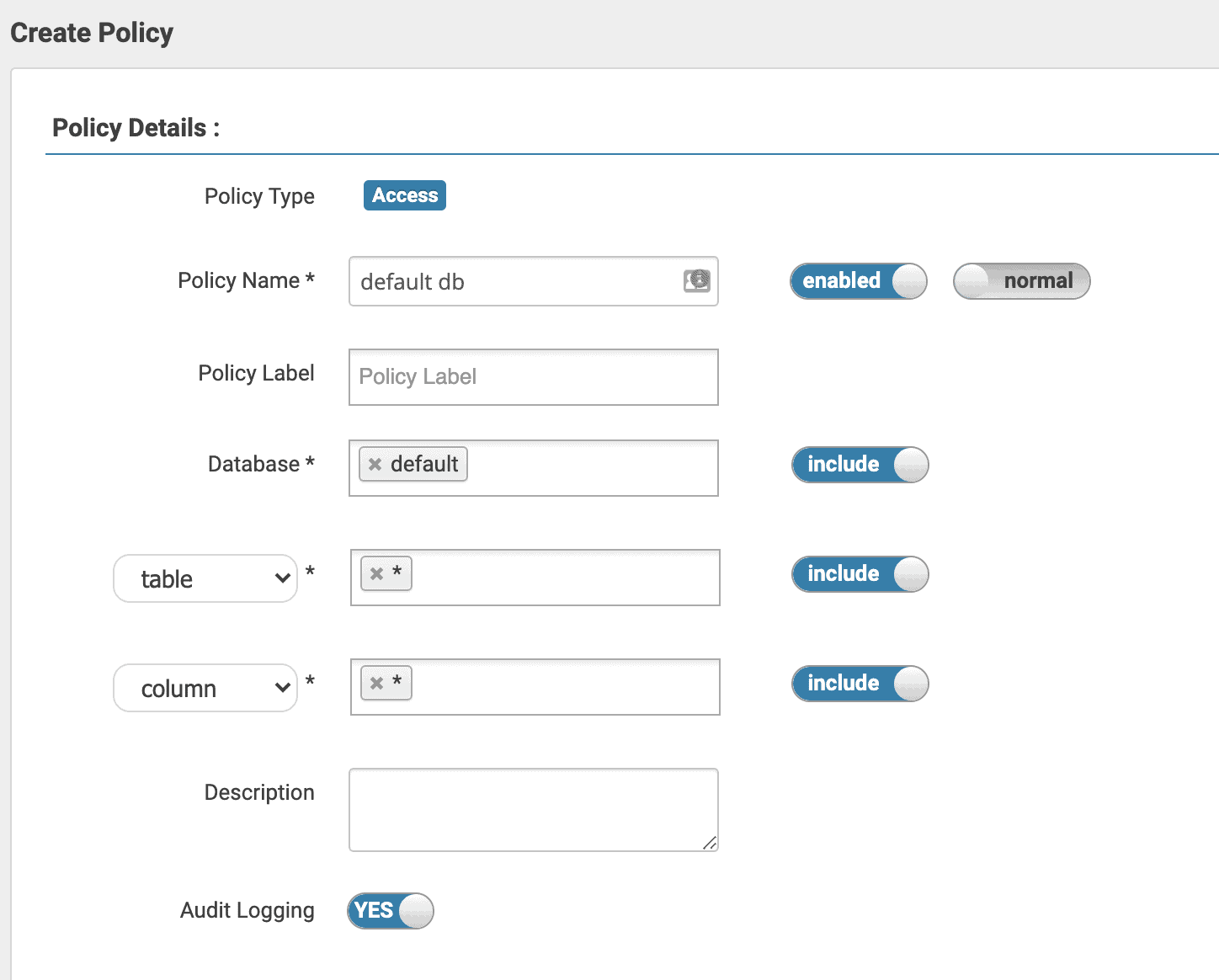

    Creating policies
    After setting up the integration it’s time to create some policies, as now only trusted users are allowed to perform any action; everyone else is locked out. Resource-based access control (RBAC) policies can be set up for Kudu in Ranger, as well as tag-based policies, row-level filtering or column masking.
    To create your first policy, log in to Ranger Admin (this can be accessed from Cloudera Manager by navigating to the Ranger service, then clicking on “Ranger Admin Web UI” in the service’s tab navigation panel), click on the “cm_kudu” service, then on the “Add New Policy” button in the top right corner. You’ll need to name the policy and set the resource it will apply to. Kudu doesn’t support databases, but with Ranger integration enabled, it will treat the part of the table name before the first period as the database name, or default to “default” if the table name doesn’t contain a period (this is configurable with the -ranger_default_database flag in “Master Advanced Configuration Snippet (Safety Valve) for gflagfile”).
    There is no implicit hierarchy in the resources, which means that granting privileges on db=foo won’t imply privileges on foo.bar. To create a policy that applies to all tables and all columns in the foo database you need to create a policy for db=foo->tbl=*->col=*. To create tables starting with foo, granting “create” privileges on db=foo is sufficient and table-level privileges are not required. Metadata should still be granted on db=foo->tbl=* as it is required to check if the newly created table exists, which is the last step of table creation.
    Create Policy
    For a list of the required privileges to perform operations please refer to our documentation.
