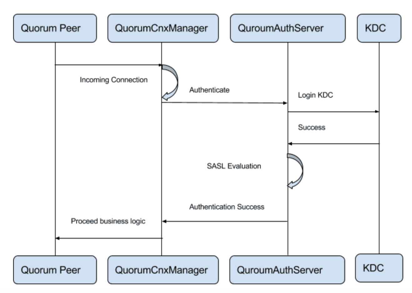

    SASL is a framework that defines a challenge-response protocol for authentication data exchange between a SASL client and a SASL server. In ZooKeeper, the SASL client and SASL server are represented as QuorumAuthLearner and QuorumAuthServer respectively, where the challenge-response process is implemented. SASL supports various schemes including Kerberos, which we will use in rest of our post. Please refer to this document for details on concepts of Kerberos.
    A basic workflow for authenticating an incoming connection request at one Quorum Peer would look like this:
    Quorum Peer
    Similarly, on the other Quorum Peer, there is a corresponding QuorumAuthLearner that authenticates the response coming from the previous Quorum Peer.
