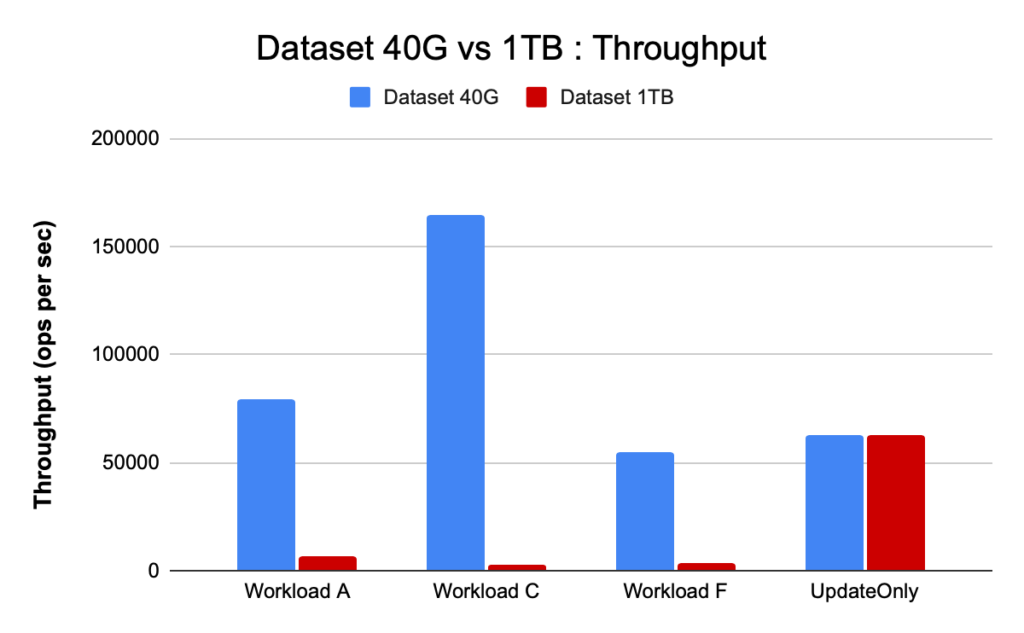

    The chart below shows the throughput and compares how throughput changed for different workloads when run with the 2 different size datasets. In the chart higher the bar the better the throughput.
    Dataset 40G vs 1TB: Throughput
    Note: Throughput = Operations per second
    As seen in the chart, the YCSB workloads which read data like Workload A, Workload C and Workload F had a much better throughput in the 40G case where the data easily fit into cache vs the 1TB data size case where the HFile data had to be accessed from HDFS

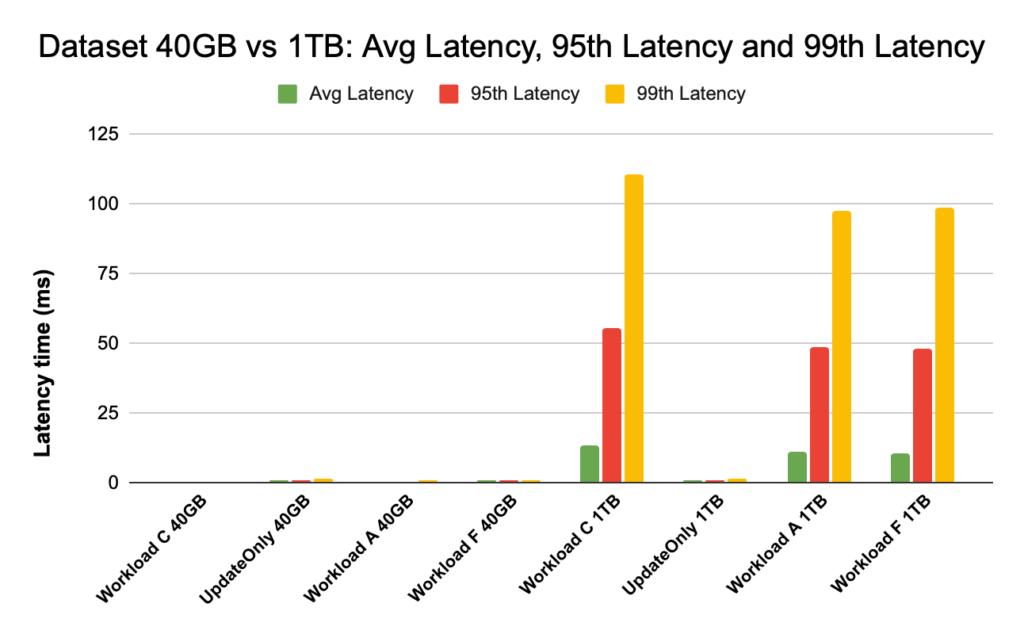

    Chart below shows the latency comparison for average latency, 95th percentile latency and 99th percentile latency and how it differs for different workloads when run with different size data sets.
    Dataset 40G vs 1TB: Avg Latency, 95th Latency and 99th Latency
    In the above chart, it’s hard to see the bars representing latency for the 40GB data set since they are extremely low as compared to latency observed for the 1TB dataset accessing data from hdfs.

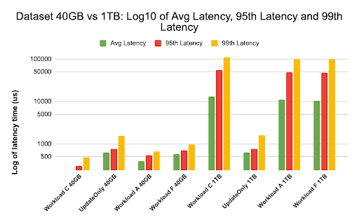

    We plotted the latency graph using log of the latency values to show the difference in the chart below
    As seen above the latencies are much lower in the 40GB case where the cache hit ratio is close to 99% and most workload data is available in the cache. In comparison for the 1TB data set, cache hit ratio was around 85% as HFile data had to be accessed from HDFS storage.
    The average and 99 latency for Workload C in the 40G case where 99% data is returned from the warmed up cache was around 2 – 4 ms. The 99th percentile latency for the same Workload C in the 1TB case was around 100ms for Workload C (read only workload).
    This shows that a cache hit from the on-heap block cache returns a read in around 2 ms and a cache miss and getting a record from HDFS could take around 100ms on this cluster.

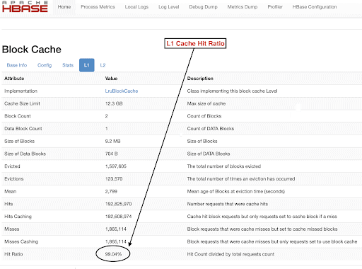

    You can also view Cache Hit ratio from the HBase Web UI following the below steps:
    1. From the HBase Web UI click on the region server
    2. Under the Block cache section select L1 (and L2 if L2 is configured) to review the cache hit ratios.
    A screenshot showing the cache hit ratio from the L1 block cache is shown below:
    HBase screenshot
    Here is a link to more info around HBase screenshot shown above and block cache https://docs.cloudera.com/runtime/7.2.2/configuring-hbase/topics/hbase-blockcache.html
