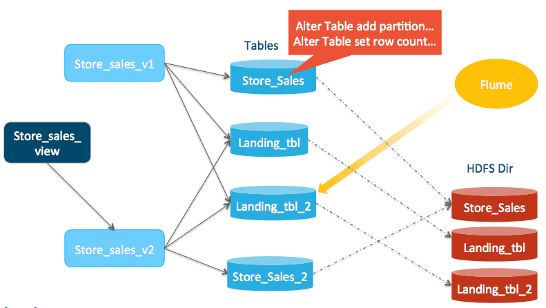

    Preparing for Compaction
    Using store_sales_landing_tbl helps achieve a high ingestion frequency. One side effect of frequent ingestion is that it will create lots of small files. File compaction is a well-understood process, but we are trying to achieve “online” compaction here: compacting files while queries and ingestion are running. To achieve that, you need a few more views/tables. The following diagram shows the proper setup.
    Diagram of Impala ingestion file compaction
    First, create a pair of tables (store_sales_2 and store_sales_landing_tbl_2). They should have the same structure and metadata as store_sales. Store_sales_2 should have exactly the same data as store_sale by pointing to the same data location as store_sales. The store_sales_landing_tbl_2 table is empty initially. Here are the create table statements: In Hive:
    Create store_sales_2 like store_sales
          location ‘/user/hive/warehouse/store_sales/’;
    Msck repair store_sales_2 (Because store_sales_2 and store_sales share the same directory, msck repair store_sales_2 will add all partitions in store_sales to store_sales_2.) In Impala:
    Invalidate Metadata store_sales_2;
    Create store_sales_landing_tbl_2 like store_sales_landing_tbl     location ‘/user/hive/warehouse/store_sales_landing_tbl_2/’; Make sure that the directories are created in HDFS and accessible (both read and write) to Impala. Now, the original view store_sales_view_1 needs to encapsulate store_sales, store_sales_landing_tbl and store_sales_landing_tbl_2. In Hive:
    create or replace view store_sales_view_1
          select * from store_sales
          union all
          select * from store_sales_landing_tbl
          union all
          select * from store_sales_landing_tbl_2;
    Create another view, store_sales_view_2, that points to store_sales_2 and landing_table_2. In Hive:
    create or replace view store_sales_view_2
          select * from store_sales_2
          union all
    Users query store_sales_view_1 via yet another view, store_sales_store_sales_view. In Hive:
    create or replace view store_sales_store_sales_view
          select * from store_sales_view_1;
    After executing the above "create or replace view in Hive", we need to propagate the new metadata to Impala via issuing the following: In Impala:
    invalidate metadata store_sales_view_1;
    invalidate metadata store_sales_view_2;
    invalidate metadata store_sales_store_sales_view;

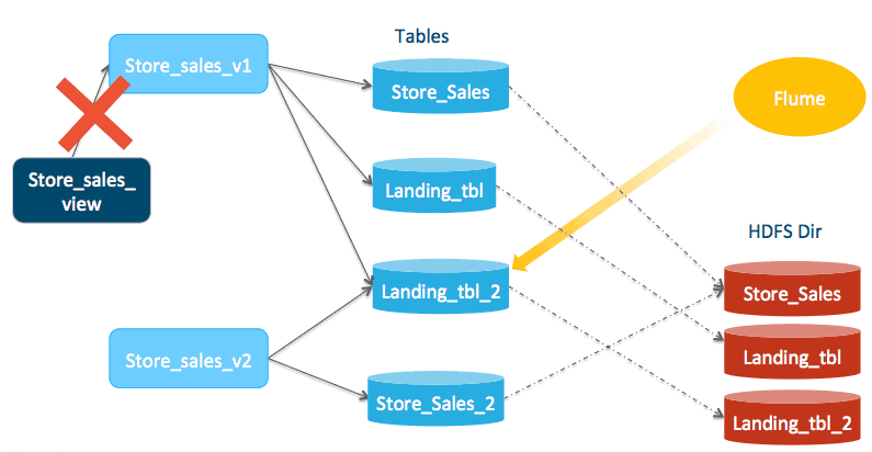

    Here’s the state of the view/table:
    store_sales_store_sales_view -> store_sales_view_1
    store_sales_view_1 -> store_sales,
    store_sales_landing_tbl, store_sales_landing_tbl_2
    store_sales_view_2 -> store_sales_2, store_sales_landing_tbl_2
    Compaction (Frequency: Daily)
    Diagram of Impala ingestion compaction frequency step 1

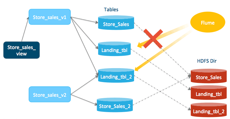

    Point the ingestion to store_sales_landing_tbl_2. Ingestion can continue without any interruption but only against the _2 tables; that is, new ingestion writes to /store_sales_landing_tbl_2/, execute msck repair store_sales_landing_tbl_2, and then refresh store_sales_landing_tbl_2 in Impala. Wait for the last ingestion that operates on store_sales_landing_tbl to finish (wait for the last refresh store_sales_landing_tbl to finish) before proceeding to the next step.

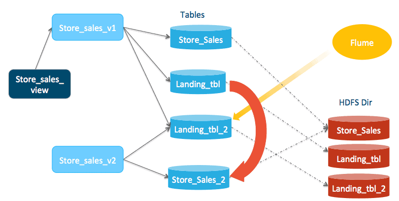

    Copy and compact the data from store_sales_landing_tbl to store_sales_2.
    INSERT INTO store_sales_2 [shuffle] select * from store_sales_landing_tbl;
    Update the row count stats for each partition in store_sales_2 that are modified. The list of modified partitions in store_sales_2 is identical to that from store_sales_landing_tbl. So, using show partitions store_sales_landing_tbl, we know which partitions of store_sales_2 are modified. Following the example above, we have two partitions in store_sales_landing_tbl. So, execute the following:
    alter table store_sales_2 partition(sales_date=20150512, store_id=123) set tblproperties(‘numRows=’7012’, STATS_GENERATED_VIA_STATS_TASK’=’true’);
    alter table store_sales_2 partition(sales_date=20150512, store_id=256) set tblproperties(‘numRows=’3451’, STATS_GENERATED_VIA_STATS_TASK’=’true’);
    Diagram of Impala ingestion compaction frequency step 3
    Next, point the store_sales_view to view store_sales_view_2. (In Hive) Create or replace view store_sales_view as select * from store_sales_view_2; (In Impala) invalidate metadata store_sales_view;
    newly incoming queries will now see the compacted data as well as data in the store_sales_landing_tbl_2. Any existing running query is unaffected and will continue to read from tables pointed by store_sales_view_1.

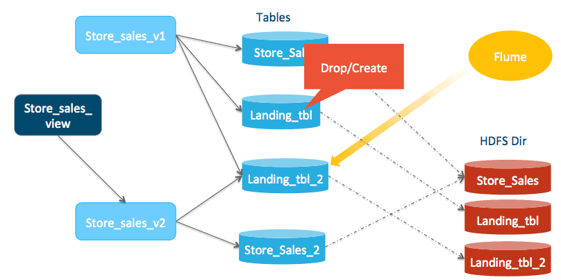

    Now we clean up the small files in store_sales_landing_tbl once all queries against store_sale_view_1 cease. Let’s say the longest query that read from store_sale_store_sales_view won’t be longer than 15 minutes. After that period, no query will be reading from view store_sales_view_1 (i.e. store_sales and store_sales_landing_tbl). Delete the original small files in store_sales_landing_tbl after 15 minutes by dropping and re-creating table store_sales_landing_tbl. It is important to do drop/re-create rather than TRUNCATE because we need to drop all partitions.
    drop table store_sales_landing_tbl;
    Create store_sales_landing_tbl like store_sales
         location ‘/user/hive/warehouse/store_sales_landing_tbl’
         stored as avro;
    Diagram of Impala ingestion file clean up

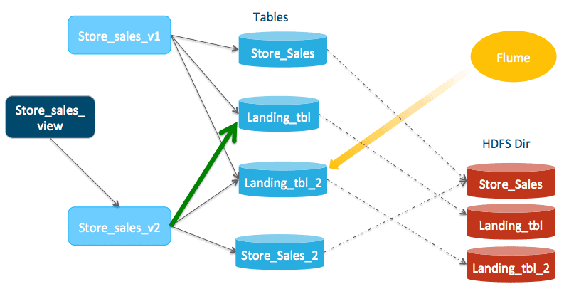

    Add store_sales_landing_tbl back to store_sales_view_2. In Hive:
    Create or replace view store_sales_view_2
         union all
         union all
    In Impala:
    Diagram of Impala ingestion synchronize metadata

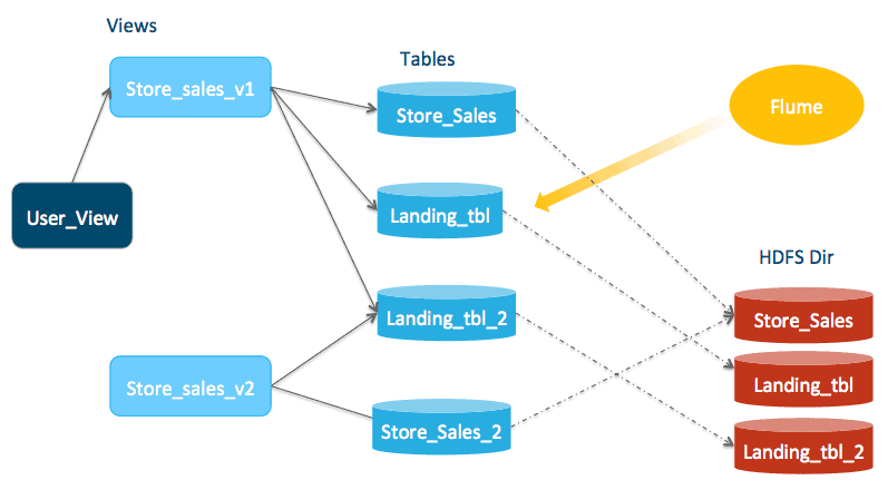

    Next, remove store_sales_landing_tbl_2 from view store_sales_view_1. In Hive:
    Create or replace view store_sales_view_1
    union all
    In Impala:
    Now the state of all the views/tables is identical to what it was initially except that it is swapped with the _2 tables! Here’s the current state:
    store_sales_view -> store_sales_view_2
    store_sales_view_1 -> store_sales, store_sales_landing_tbl
    store_sales_view_2 -> store_sales_2, store_sales_landing_tbl_2, store_sales_landing_tbl
    Diagram of completed Impala ingestion
