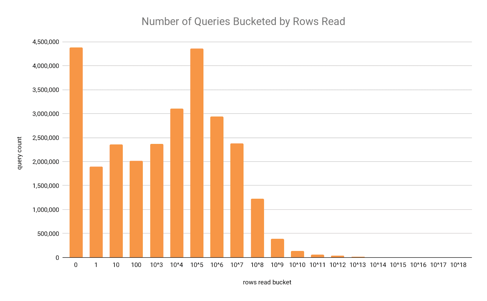

    Below is a small anonymized sample of real user queries from various customers across the last 12 months totaling about 28 million data points. The x-axis is the log10 of the number of rows read in the query after partition pruning and index filtering has skipped potentially many more rows. About 31% of the queries, spread out across the first three buckets, read from 0 to 100 rows. Then again the 23 queries in the last three buckets read half as many rows as the rest of the 28 million queries combined. The first three buckets of queries where 100 rows or less were read, about a third of overall Impala usage, had a mean runtime of just under 300ms! So clearly Impala is used extensively with datasets both small and large.
    Number of Queries Bucketed by Rows Read

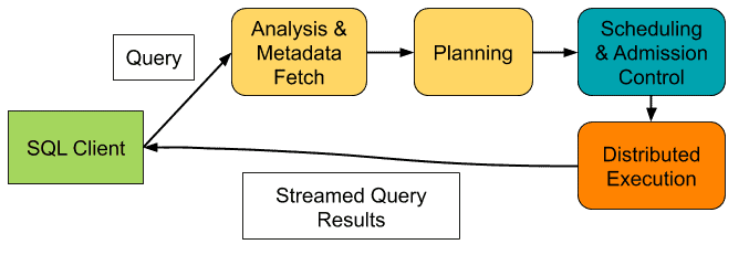

    We’ll discuss the various phases Impala takes a query through and how small query optimizations are incorporated into the design of each phase. It helps to have an understanding of the “life of a query” as illustrated in the diagram below. Once a query is submitted from a client the first two phases broadly constitute query compilation, then if enough resources are available it is admitted and scheduled across the cluster and finally executed. For a more in-depth description of these phases please refer to Impala: A Modern, Open-Source SQL Engine for Hadoop.

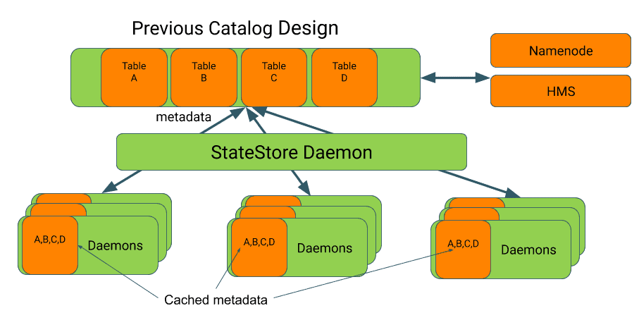

    Previous catalog design
    In the previous design each Impala coordinator daemon kept an entire copy of the contents of the catalog cache in memory and had to be explicitly notified of any external metadata changes.

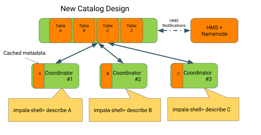

    New catalog design
    The new Catalog design means that Impala coordinators will only load the metadata that they need instead of a full snapshot of all the tables. A new event notification callback from the HMS will inform the catalog service of any metadata changes in order to automatically update the state. See the performance results below for an example of how metadata caching helps reduce latency.

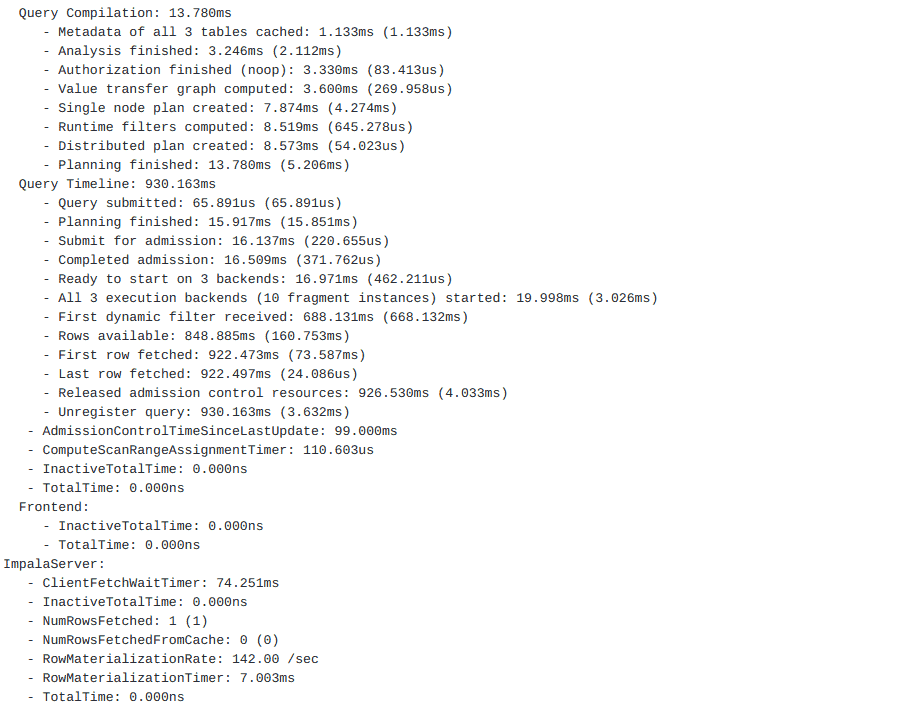

    A query profile is a detailed recap of the performance and runtime of various parts of query execution. A query profile can be obtained after running a query in many ways by: issuing a PROFILE; statement from impala-shell, through the Impala Web UI, via HUE, or through Cloudera Manager. Our query completed in 930ms. Here’s the first section of the query profile from our example and where we’ll focus for our small queries.
    Query Compilation
    The first section on query compilation covers the time for preparing and planning the query. This includes the time to fetch the metadata and schema for our tables. As we discussed previously, Impala tries to cache and optimize this metadata.
    Query Compilation: 13.780ms
    - Metadata of all 3 tables cached: 1.133ms (1.133ms)
    - Analysis finished: 3.246msms (2.112ms)

    Let’s drill into some of the other parts of the Query Compilation process:
    - Value transfer graph computed
    - Analysis finished
    High wait times in these areas might mean there are many columns or expressions to analyze, and this can happen especially when many logical views exist with 100s of columns defined in the view but not necessarily used in the query. The query option ENABLE_EXPR_REWRITES can be used to reduce the number of passes over these columns in cases where the Analysis time appears high.
    - Authorization finished
    Large values here indicate latency issues with authorization and permission checks, this can mean issues with Apache Sentry or Apache Ranger. In some cases it may indicate a problem looking up user group information from LDAP or the local directory provider.
    - Single node plan created
    - Distributed plan created
    A single node plan is the simplest possible execution strategy for a given query. In order to convert this simple form into a distributed plan multiple optimization passes are run over the query plan. Having many joins, logical views, or inaccurate table statistics can slow this process down. If you noticed large delays here and your statistics are up to date or reducing the numbers of tables in the query is not an option, consider adding planner hints to the query. This will skip certain optimization steps and instead directly follow the provided hint.
    Query Timeline
    This section covers the time spent on various aspects of the runtime of the query after planning is complete.
    - Submit for admission
    - Completed admission
    Long wait times for admission has to do with any admission control and queuing policies that have been configured to manage multiple concurrent users.
    - Ready to start on 3 backends -
    All 3 execution backends (10 fragment instances) started
    Any large time difference at this point represents the overhead of initializing and starting distributed execution across the cluster. There are inherent network communication latencies with contacting all the nodes and ensuring they are ready to process the query. For certain types of small queries it may be more beneficial to execute the query on a single node and bypass the communication overhead if it is close to the total execution time of the query, we’ll discuss how this can be done automatically or explicitly with the NUM_NODES option below.
    - First dynamic filter received
    - Rows available
    - First row fetched
    A large gap between the “Rows available” time and “First row fetched” time usually signifies issues with the client that submitted the query not requesting the results in a timely manner.
    - Last row fetched
    - Released admission control resources:
    - Unregister query
