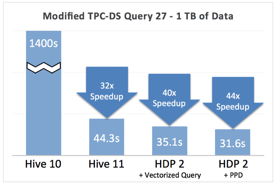

    ORCFile is an important piece of our Stinger Initiative to improve Hive performance 100x. To show the impact we ran a modified TPC-DS Query 27 query with a modified data schema. Query 27 does a star schema join on a large fact table, accessing 4 separate dimension tables. In the modified schema, the state in which the sale is made is denormalized into the fact table and the resulting table is sorted by state. In this way, when the query scans the fact table, it can skip entire blocks of rows because the query filters based on the state. This results in some incremental speedup as you can see from the chart below.
    Modified TPC-DS Query 27 - 1 TB of Data
