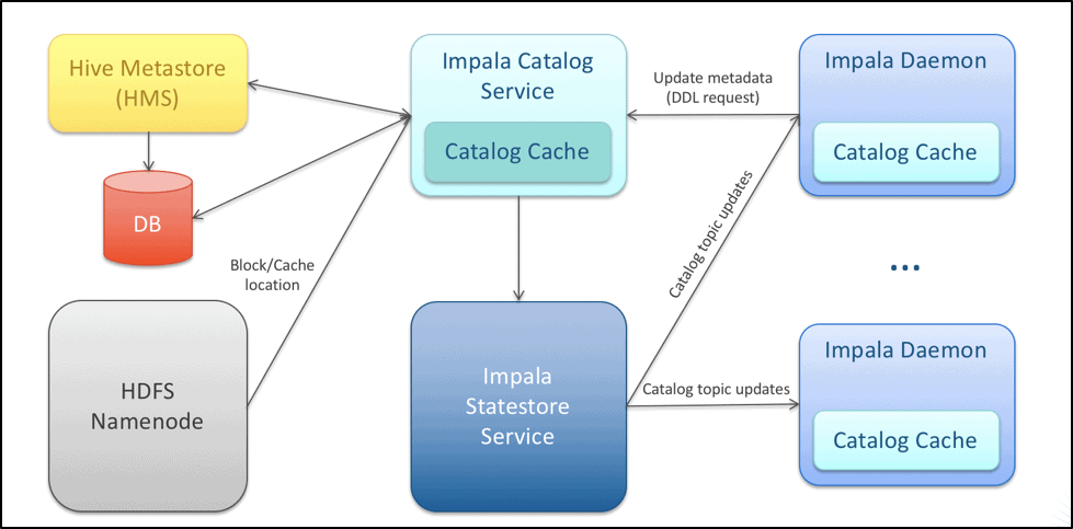

    Impala—Effects on the Catalog Server
     Impala is a high-performance query engine, which caches the HDFS namespace information in the Catalog Server for faster metadata access. Below is an architecture diagram detailing the way the Impala catalog is maintained and distributed across the service.
    As seen with complications around NameNode metadata management, a similar issue arises with the metadata that Impala needs to maintain in the Catalog Server. The catalog size is a function of the number and size of objects maintained in the Catalog Server. These objects with their estimated average memory usage are described in the table below:

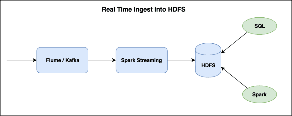

    Streaming Data
    Data ingested incrementally and in small batches can end up creating a large number of small files over a period of time. Near-real-time requirements for streaming data, with small windows (every few minutes or hours) that do not create much data will cause this problem. Below is a typical streaming ETL ingest pipeline into HDFS.
    Real time ingest into HDFS

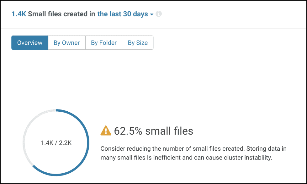

    Cloudera Navigator
    Cloudera Navigator is a data governance product with audit, lineage, metadata management, data stewardship and policy enforcement features.
    The Navigator Search and Analytics tabs can be used to identify small files easily. The HDFS search filters in the left panel allows to filter for files under a specific size or range. The new version of Cloudera Navigator (2.14.x) even has an in-built Dashboard widget to identify small files as shown below.
