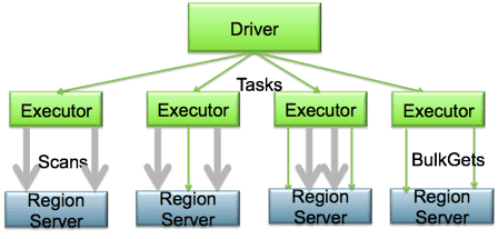

    We assume Spark and HBase are deployed in the same cluster, and Spark executors are co-located with region servers, as illustrated in the figure below.
    Figure 1. Spark-on-HBase Connector Architecture
    At a high-level, the connector treats both Scan and Get in a similar way, and both actions are performed in the executors. The driver processes the query, aggregates scans/gets based on the region’s metadata, and generates tasks per region. The tasks are sent to the preferred executors co-­located with the region server, and are performed in parallel in the executors to achieve better data locality and concurrency. If a region does not hold the data required, that region server is not assigned any task. A task may consist of multiple Scans and BulkGets, and the data requests by a task is retrieved from only one region server, and this region server will also be the locality preference for the task. Note that the driver is not involved in the real job execution except for scheduling tasks. This avoids the driver being the bottleneck.
