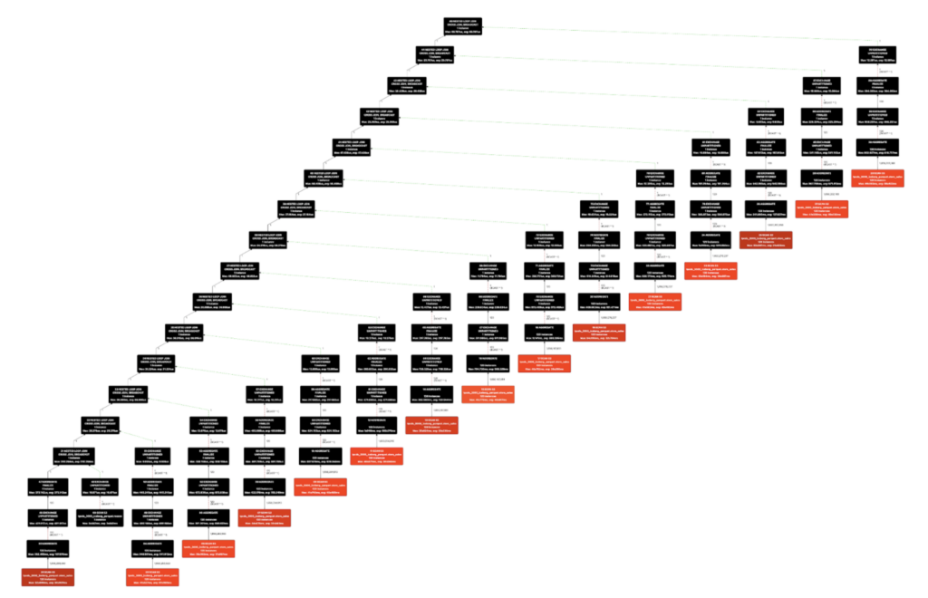

Figure 1. store_sales table scanned 15 times with varying filter predicates in TPC-DS Q9 Figure 1. store_sales table scanned 15 times with varying filter predicates in TPC-DS Q9
In Hive table format, the table metadata such as partition information and statistics are stored in Hive Metastore (HMS). Impala can access Hive table metadata fast because HMS is backed by RDBMS, such as mysql or postgresql. Impala also caches table metadata in CatalogD and Coordinator’s local catalog, making table metadata analysis even faster if the targeted table metadata and files were previously accessed. This caching is important for Impala since it may analyze the same table multiple times across concurrent query planning and also within single query planning. Figure 1 shows a TPC-DS Q9 plan where one common table, store_sales, is analyzed 15 times to plan 15 separate table scan fragments.

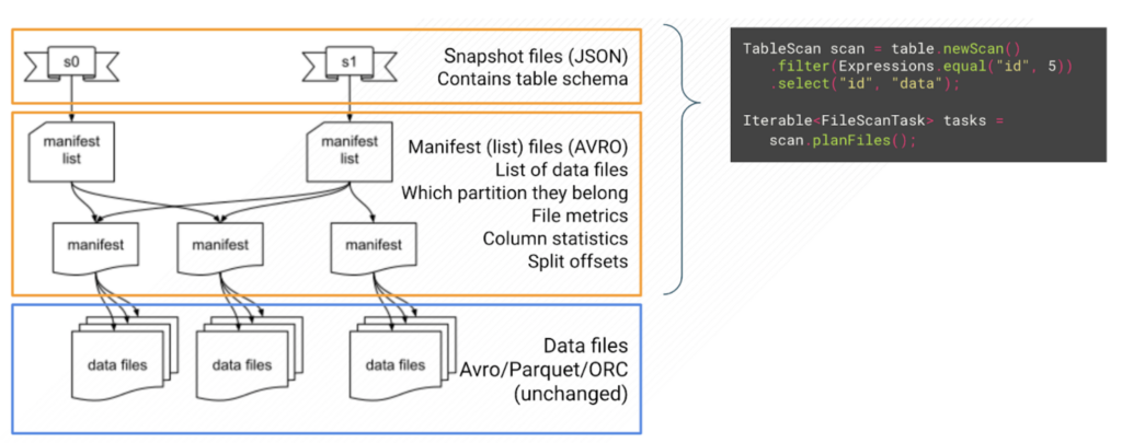

In contrast, Iceberg table format stores its metadata as a set of files in the file system, next to the data files. Figure 2 illustrates the three kinds of metadata files: snapshot files, manifest list, and manifest files. The data files and metadata files in Iceberg format are immutable. New DDL/DML operation over the Iceberg table will create a new set of files instead of rewriting or replacing prior files. Every table metadata query through Iceberg Java API requires reading a subset of these metadata files. Therefore, each of them also incurs an additional storage latency and network latency overhead, even when some of them are analyzing the same table. This problem is described in IMPALA-11171.

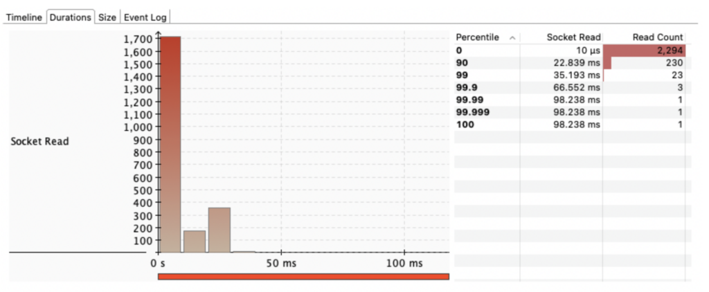

Figure 3. Multiple socket read activities during TPC-DS Q9 planning over Iceberg table on S3. Figure 3. Multiple socket read activities during TPC-DS Q9 planning over Iceberg table on S3.

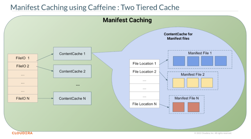

We filed pull request 4518 in the Apache Iceberg project to implement this caching mechanism. The idea is to cache the binary content of manifest files (the lowest of Iceberg metadata files hierarchy) in memory, and let Iceberg Java Library read from the memory if it exists instead of reading again from the file system. This is made possible by the fact that Iceberg metadata files, including the manifest files, are immutable. If an Iceberg table evolves, new manifest files will be written instead of modifying the old manifest files. Thus, Iceberg Java Library will still read any new additional manifest files that it needs from the file system, populating manifest cache with new content and expiring the old ones in the process.
Figure 4 illustrates the two-tiered design of the Iceberg manifest cache. The first tier is the FileIO level cache, mapping a FileIO into its own ContentCache. FileIO itself is the primary interface between the core Iceberg library and underlying storage. Any file read and write operation by the Iceberg library will go through the FileIO interface. By default, this first tier cache has a maximum of eight FileIO that can simultaneously have ContentCache entries in memory. This amount can be increased through Java system properties iceberg.io.manifest.cache.fileio-max.
The second tier cache is the ContentCache object, which is a mapping of file location path to the binary file content of that file path. The binary file content is stored in memory as a ByteBuffer of 4MB chunks. Both of the tiers are implemented using the Caffeine library, a high-performance caching library that is already in use by Iceberg Java Library, with a  combination of weak keys and soft values. This combination allows automatic cache entries elimination on the event of JVM memory pressure and garbage collection of the FileIO. This cache is implemented in the core Iceberg Java Library (ManifestFiles.java), making it available for immediate use by different FileIO implementations without changing their code.

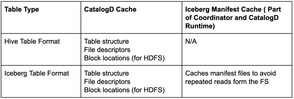

Impala Coordinator and CatalogD can do a fast file listing and data file pruning over an Iceberg table using this Iceberg manifest cache. Note that Iceberg manifest caching does not eliminate the role of CatalogD and Coordinator’s local catalog. Some table metadata such as table schema, file descriptors, and block locations (for HDFS backed tables) are still cached inside CatalogD. Together, CatalogD cache and Iceberg manifest cache help achieve fast query planning in Impala.
Table 1. CatalogD and Iceberg Manifest Cache role across table formats. Table 1. CatalogD and Iceberg Manifest Cache role across table formats.

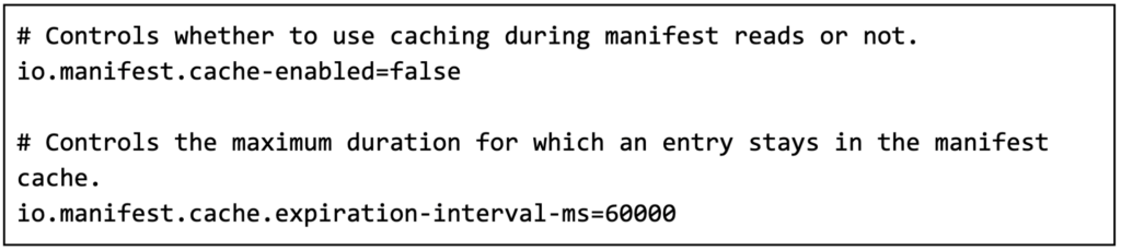

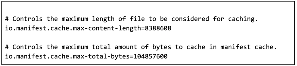

Individual per-FileIO ContentCache can be tuned through their respective Iceberg Catalog properties. The description and default values for each properties are following:

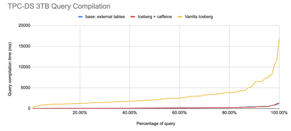

Figure 5. Inverse CDF of Impala query compilation time over TPC-DS queries 3TB scale Figure 5. Inverse CDF of Impala query compilation time over TPC-DS queries 3TB scale
Impala and other query engines can leverage the manifest caching feature starting from Apache Iceberg version 1.1.0. Figure 5 shows the improvement in compilation time by Impala front end. The x-axis represents the percentage of queries in TPC-DS workload, and the y-axis represents the query compilation time in milliseconds. Compared to Iceberg without manifest caching (Vanilla Iceberg), enabling Iceberg manifest caching can improve query compilation 12 times faster (Iceberg + caffeine), almost matching the performance over the Hive external table. One caveat is that, in Impala, the io.manifest.cache.expiration-interval-ms config is increased higher to one hour in Coordinator. This is beneficial for Impala because for the default Hive catalog, Impala front end maintains a singleton of Iceberg’s HiveCatalog that is long lived. Setting a long expiration is fine since Iceberg files are immutable, as explained in the design section above. A long expiration time will also allow cache entries to live longer and be utilized for multiple query planning targeting the same tables.

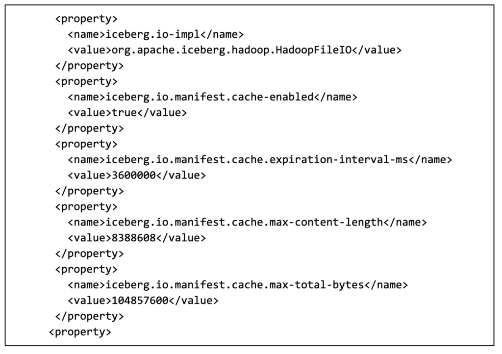

Impala currently reads its default Iceberg catalog properties from core-site.xml. To enable Iceberg manifest caching with a one hour expiration interval, set the following configuration in Coordinator and CatalogD service core-site.xml:
Configuration in Coordinator and CatalogD service core-site.xml
