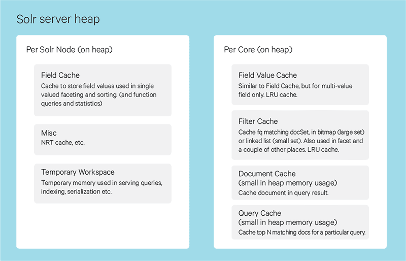

    Before we start estimating Solr memory requirement, let’s take a quick look at how Solr uses memory. There are two types of memory Solr can use, heap memory and direct memory ( often called off-heap memory). Direct memory is used to cache blocks read from file system, similar to Linux file system cache.  For heap memory, the following diagram shows various major consumers inside Solr.
    Solr server heap
    As you can see, a large portion of heap memory is used by multiple caches. Except for field cache, other caches are per core. A Solr core is a slice of index. A Solr server usually has multiple cores. The maximum memory a cache uses is controlled by individual cache size configured in solrconfig.xml.

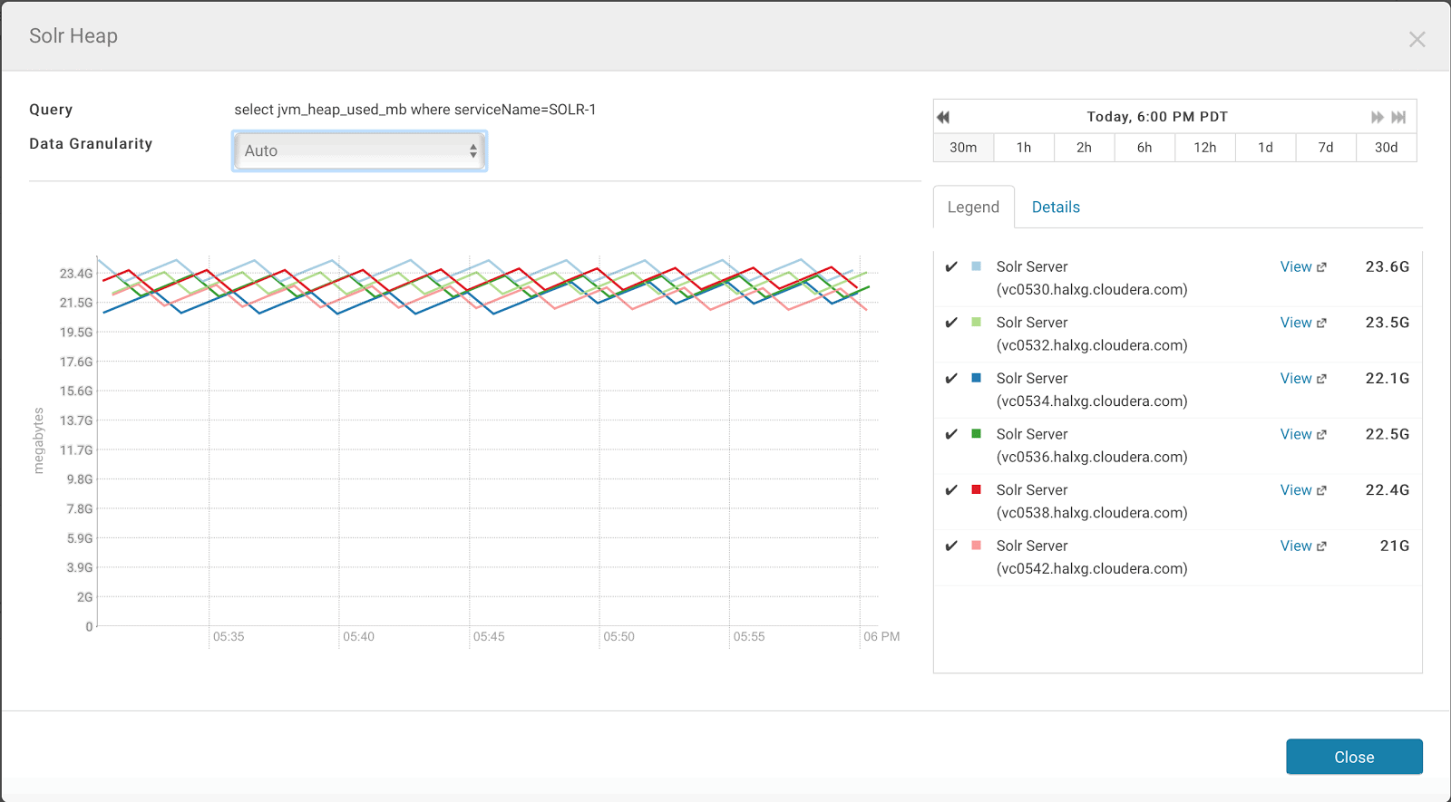

    Jvm_heap_used_mb tells us how much heap Solr is actually using inside JVM. It should go up and down around Solr memory requirement estimation in JVM Heap Size section. Cloudera manager collect one sample per minute. Therefore, the metric may not reflect all memory usage spikes. As mentioned early, make sure there is enough buffer memory inside heap to accommodate sporadic memory usage spike and reduce GC overhead.

    The easiest way to monitor these key metrics are CM dashboards. You can easily build a  dashboard using Cloudera Manager for every metric using queries similar to the example below.
    select jvm_heap_used_mb where serviceName=SOLR-1
    Here is the dashboard created from the query above.
    Both real time metric value and long term trend are important. Real time value tells how Solr is performing. Long term trend is a good sign if something is changing in the system, such as workload, index size, etc.
    CM dashboard would perform downsample when you look long term trend. For example, if you look at JVM heap usage for 30-day period, the dashboard shows three values, max, min, mean. For JVM heap usage, monitor the max value in addition mean value.
