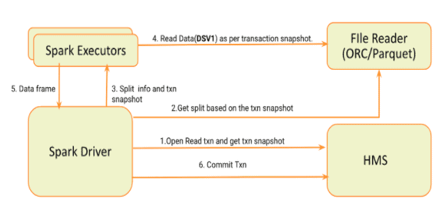

    Behind the scenes – Read Architecture
    Spark Direct Reader is built on top DataSource V1 APIs exposed by spark which allows us to plug in custom data sources to spark. In our case the custom data source is the layer which enables us to read hive ACID tables.
    Following diagram depicts the high level read process and transaction management in connector.
    1.  Spark Driver parses the query and for each ACID table starts a read txn.
    2. Transaction snapshot for each table is stored separately and is used for generating the split.
    3. Spark driver serializes and sends the partition info and txn snapshot to executors.
    4.  Executors read the specific split using the transaction snapshot.
    5.  Processed and transformed data is sent back to the driver.
    6.  Driver commits the read transactions started.
