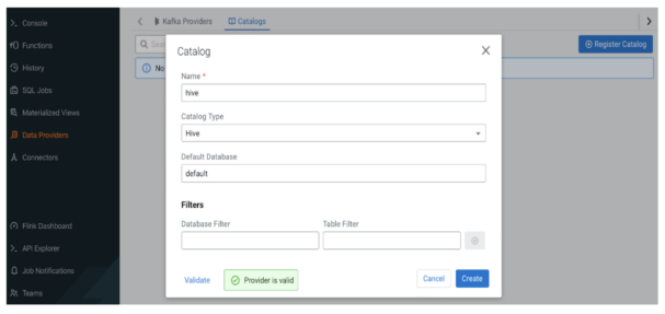

    SQL Stream Builder (SSB) was built to give analysts the power of Flink in a no-code interface.  SSB has a simple way to register a Hive catalog:
    1. Click on the “Data Providers” menu on the sidebar
    2. Click on “Register Catalog” in the lower box
    3. Select “Hive” as catalog type
    4. Give it a name
    5. Declare your default database
    6. Click “Validate”
    7. Upon successful validation, click on “Create”

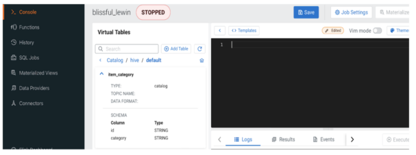

    After the above steps, your Hive tables will show up in the tables list after you pick it as the active catalog. Currently, via the catalog concept Flink supports only non-transactional Hive tables when accessed directly from HDFS for reading or writing.

    Using the Flink JDBC connector, a Flink table can be created for any Hive table right from the console screen, where a table’s Flink DDL creation script can be made available. This will specify a URL for the Hive DB and Table name. All Hive tables can be accessed this way regardless of their type. JDBC DDL statements can even be generated via “Templates”. Click “Templates” –> “jdbc” and the console will paste the code into the editor.

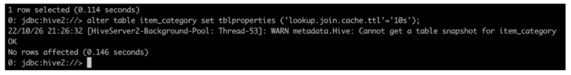

    For Hive Catalog tables, the TTL (time to live) of the cached lookup table can be configured using the property “lookup.join.cache.ttl” (the default of this value is one hour) of the Hive table like this from Beeline or Hue:
