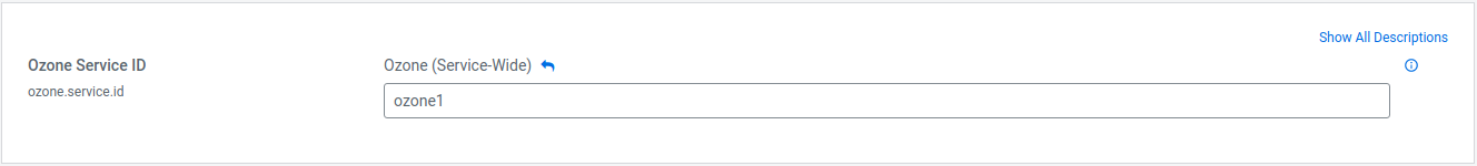

    The Ozone URI takes the form of ofs:////. If you don’t know the first part, you can easily find it in Cloudera Manager by going to Clusters > Ozone and choosing the configuration tab. From there you can search for service.id and see something like
    Ozone Service ID UI screen.

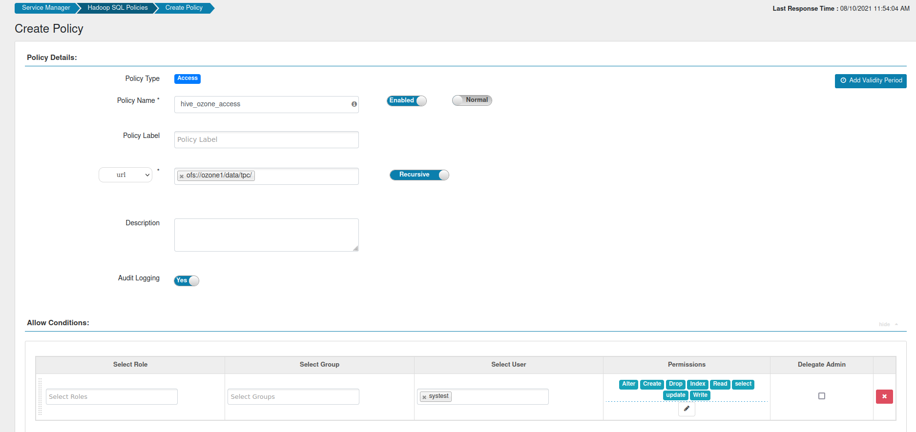

    With our bucket created, let’s finalize security for Hive. I mentioned at the beginning that you’d require a user with fairly open access in Hive and Ozone. However, despite that access, there’s still one more policy required for us to create tables that point to a location in Ozone. Now that we’ve created that location, we can create a policy like below:
    Create policy step screen
    As you can see, this utilizes the URI in Ozone where we loaded data. By creating this policy, we’re allowing SQL actions access to the volume and the bucket within it. Thus, we’re able to create tables in Hive.

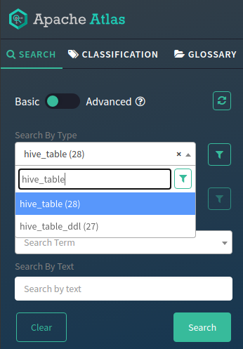

    Once tables are in place, we can begin to see lineage in Atlas. To view the tables you’ve created, pull down the Search By Type bar and enter hive_table. Once that’s been selected, click the search button to view all tables.

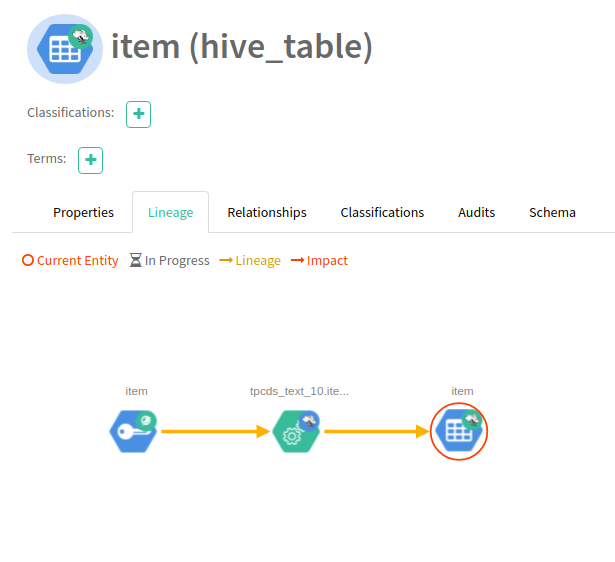

    Click on the table you want to view and notice the lineage tab on the right (see below). You’ll notice that Hive tables and processes are present but so are Ozone keys.
    Item (hive_table)

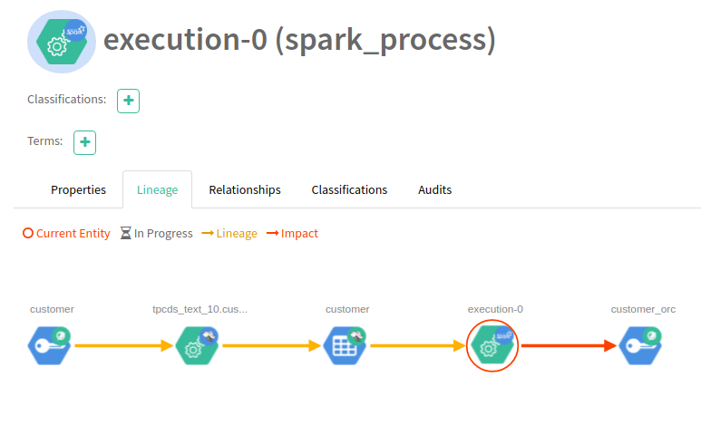

    Going back to Atlas, you can see the lineage has propagated from our Spark process.
    Execution Spark Process Lineage process screen
