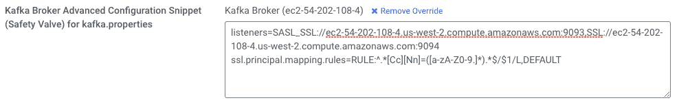

    1. In Cloudera Manager, click on Kafka > Instances > Kafka Broker (click on an individual broker) > Configuration. An alert will be shown and you can ignore it by clicking on Continuing Editing Role Instance.
    2. Set the following property for the Kafka Broker (using your own broker’s fully-qualified hostname) and save the configuration.
    We are setting two different properties at once in this safety valve: listeners and ssl.principal.mapping.rules. Note the different protocols and ports for each listener in the listeners property.
