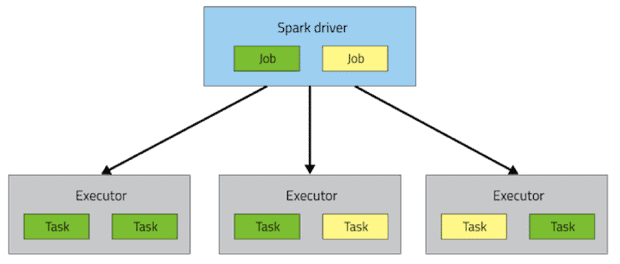

    A Spark application consists of a single driver process and a set of executor processes scattered across nodes on the cluster.
    The driver is the process that is in charge of the high-level control flow of work that needs to be done. The executor processes are responsible for executing this work, in the form of tasks, as well as for storing any data that the user chooses to cache. Both the driver and the executors typically stick around for the entire time the application is running, although dynamic resource allocation changes that for the latter. A single executor has a number of slots for running tasks, and will run many concurrently throughout its lifetime. Deploying these processes on the cluster is up to the cluster manager in use (YARN, Mesos, or Spark Standalone), but the driver and executor themselves exist in every Spark application.

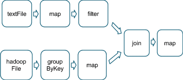

    Here is a more complicated transformation graph including a join transformation with multiple dependencies.
    The pink boxes show the resulting stage graph used to execute it.
