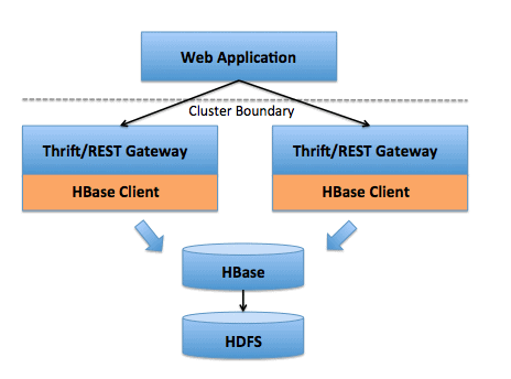

    For both Thrift and REST to work, another HBase daemon needs to be running to handle these requests. These daemons can be installed with the hbase-thrift and hbase-rest packages.  The diagram below shows how Thrift and REST are placed in the cluster.
    HBase Thrift
    Note that the Thrift and REST client hosts usually don’t run any other services (such as DataNodes or RegionServers) to keep the overhead low and responsiveness high for REST or Thrift interactions.
    Make sure to install and start these daemons on nodes that have access to both the Hadoop cluster and the application that needs access to HBase. The Thrift interface doesn’t have any built-in load balancing, so all load balancing will need to be done with external tools such a DNS round-robin, a virtual IP address, or in code. Cloudera Manager also makes it really easy to install and manage the HBase REST and Thrift services. You can download and try it out for free in Cloudera Standard!
