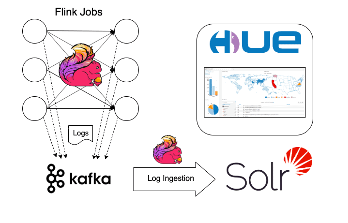

    Log aggregation with Flink, Kafka and Solr
    In this initial solution, let us use the processing frameworks available at our disposal in the Cloudera platform to build a scalable and fully customizable log aggregation stack.
    Our goal is to build a log aggregation pipeline that can serve our real-time data processing applications, and any data processing or other kind of application.
    We implement our log aggregation components using the following systems:
    1. Apache Kafka log appender for scalable and low latency log collection
    2. Log ingestion, indexing and custom monitoring using Apache Flink
    3. Apache Solr for storage and search capabilities
    4. Hue for logging dashboards
    Before diving into the nitty gritty details, let’s look at a high level example on how log messages flow from our applications all the way to the logging dashboards:
    As our data processing jobs are running on multiple servers, each worker node (TaskManager in case of Flink) is producing a continuous stream of logs. These logs are automatically sent to a designated Kafka topic using a pre-configured log appender. At the same time, completely decoupled from the applications that are producing the logs, we have another Apache Flink streaming application that listens to the log messages from Kafka. This ingestor streaming job takes incoming log messages, parses them, and indexes them via our Solr search engine. Engineers responsible for the smooth operation of the streaming applications interact at the indexed logs in Solr directly or using Hue as a dashboarding tool.
