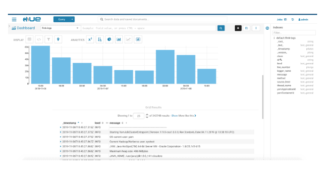

    Log Dashboards with Hue
    Now that our logs are continuously processed and indexed by our Flink job, the final step is to expose this to end-users via an interactive graphical interface. While Solr itself provides a web interface for searching the logs, we can get much better insights by creating some nice dashboards for our log data. For this, we will use Hue.
    Hue is a web-based interactive query editor that enables you to interact with data warehouses. It also comes with some advanced dashboarding capabilities that allow us to monitor our logs over time.
    On the Dashboard page, we get immediate access to our Solr collections. On the right-hand side of the screen we can see all the logged fields that are available to us, so we can drag and drop them easily to select what we really need.
    We can also create different plots and charts to track different metrics develop over time.

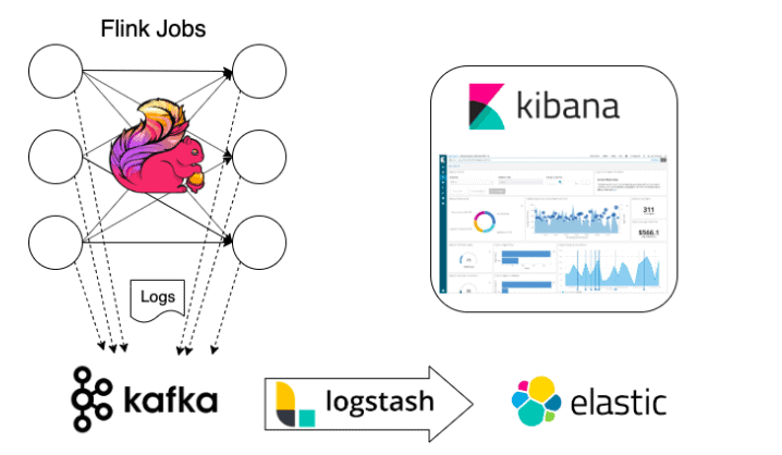

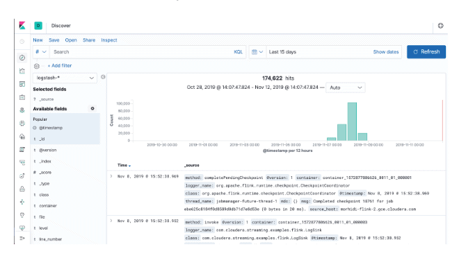

    The ELK stack
    The Elasticsearch – Logstash – Kibana (aka ELK) stack is commonly used for collecting and monitoring application logs and metrics. It should satisfy all the log aggregation requirements that our streaming apps have.
    Similarly to our custom pipeline, it comes with its own log ingestion logic using logstash. The logs are stored in elasticsearch. Kibana sits on top of Elastic as a visual dashboarding layer where we can customize our monitoring logic.
    As logstash can be configured to consume logs directly from Kafka, we can reuse the same log appender/collection logic that we have configured for our own custom solution.
    The ELK stack is a viable solution if our data processing stack already contains some of these frameworks (Elastic for example). In this case, we just have to take care of setting up Logstash, or a tool like Apache NiFi in a way that matches our desired ingestion logic.
    If we want to bring the whole ELK stack as new technology into our organization, we have to be aware of the operational overhead of this choice. As with any other system, it comes with its own set of challenges and costs.

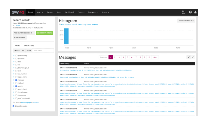

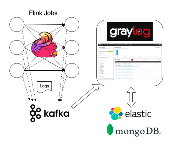

    Graylog
    Graylog is a system designed specifically for log aggregation and monitoring. It comes with its own log ingestion logic and custom appenders that can be configured to consume our logs directly.
    Similarly to logstash, we can also configure Graylog to consume our log messages from Kafka, which reinforces our choice for Kafka as a log collection layer, no matter what downstream logging stack we use.
    Graylog itself stores the log messages in elastic and it uses mongodb to store the metadata of our configuration, dashboards etc.
    Similar to the ELK stack, Grayloag can be an excellent choice for our logging stack, if we have the expertise to operate the stack at hand.
