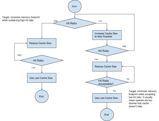

    One of the key metrics to measure cache effectiveness is cache hit ratio, which is the percentage of queries that are satisfied by cache. You can monitor cache hit ratio using Cloudera Manager as mentioned in Monitoring section of blog part 1. Ideally the hit ratio is higher than 90% in production system. Cache hit ratio mainly depends on both cache size and workload pattern. While it requires detailed analysis of workload to find out optimal cache setting, the following diagram shows some simple steps that can greatly improve cache effectiveness.
    The following diagram shows some simple steps that can greatly improve cache effectiveness
    First, apply production workload to your system and monitor cache hit ratio. In part 1 of this blog, you can find how to monitor cache hit ratio in Monitoring section.
    If cache hit ratio is high (>85%), that’s good. The target of tuning is minimizing memory requirement while sustaining high hit ratio as shown in diagram above. You can repeat reducing cache size and monitor hit ratio until hit ratio becomes too low.
    If cache hit ratio is low, increasing cache size to maximum size allowed based on your hardware availability. For example, let’s say there is 16G extra memory left on the server that can be allocated to Solr and you are tuning filter cache. Each filter cache entry can use up to 12.5M bytes of memory as shown above. Then you can increase cache size around 16G*0.7/12.5M=900 and increase JVM heap size by 16G. If cache hit ratio becomes high, continue with the previous step until you find best cache size.
    If cache hit ratio is still low after cache size is increased to max allowed, it usually means that queries in your workload are too diverse that your workload can’t take advantage of cache. In this case, high hit ratio is no longer a reasonable target. The main tuning target becomes minimizing memory requirement as shown in the diagram above.
