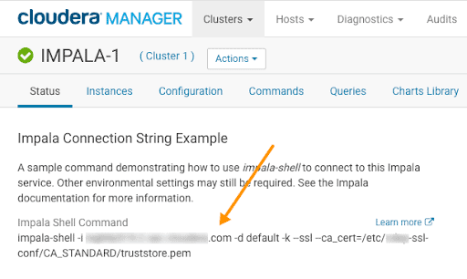

    If you are working on a secure cluster or have problems logging in to the Impala shell, you can get the appropriate connection string to log into it in Cloudera Manager:
    a. In the Cloudera Manager Admin Console Home page, click Impala in the list of services.
    b. On the Impala service page, make sure the Status tab is selected.
    c. An Impala Connection String Example is listed at the top of the page:
