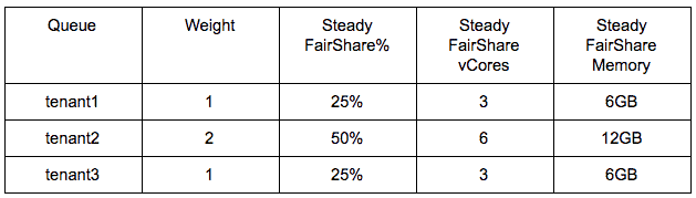

    Steady FairShare
    The FairScheduler uses hierarchical queues. Queues are sibling queues when they have the same parent. The weight associated with a queue determines the amount of resources a queue deserves in relation to its sibling queues. This amount is known as Steady FairShare. The Steady FairShare is calculated at queue level and for the root queue it is the equivalent to all the cluster resources. The Steady FairShare for a queue is calculated as follows:
    Steady FairShare formula
    This number only provides visibility into resources a queue can expect, and is not used in scheduling decisions, including preemption. In other words, it is the theoretical FairShare value of a queue.
    For example, let’s say YARN is managing a total of 12 vCores and 24GB memory. If three tenant queues need to be configured, then Steady FairShare is calculated based on assigned weights as follows:

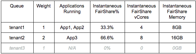

    Instantaneous FairShare
    In order to enable elasticity in a multi-tenant cluster, FairScheduler allows queues to use more resources than their Steady FairShare when a cluster has idle resources. An active queue is one with at least one running application, whereas an inactive queue is one with no running applications.
    Instantaneous FairShare is the calculated FairShare value for each queue based on active queues only.  This does not mean that this amount of resources are reserved for this queue. To enforce Instantaneous FairShare, you must enable preemption and configure FairShare Starvation as discussed in the next section.
    Instantaneous FairShare Calculation
    This value differs from Steady FairShare in that inactive queues are not assigned any Instantaneous FairShare. The two values are equal when all queues are active.
    In the above example, if only tenant1 and tenant2 queues are active, then the Instantaneous FairShare will be computed as follows:

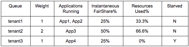

    Starvation and Preemption
    Starvation and Preemption are related concepts and are best discussed together.
    Due to the elasticity feature in FairScheduler, applications running in a queue can keep other applications (running in the same queue or a different queue) in a starved state. In the previous example, let’s say only tenant1 and tenant2 queues were active and used all of 33.3% and 66.6% of resources respectively. Subsequently, if tenant3 also becomes active, Instantaneous FairShare of tenants will change to 25%, 50% and 25% respectively. However, application(s) in tenant3 queue will have to wait for applications in tenant1 and/or tenant2  to release resources. Until then, tenant3 will have unmet demand or “starvation” in form of pending containers.
    Preemption allows this imbalance to be adjusted in a predictable manner. It enables reclamation of resources from queues exceeding their FairShare without waiting for queues to release resources.

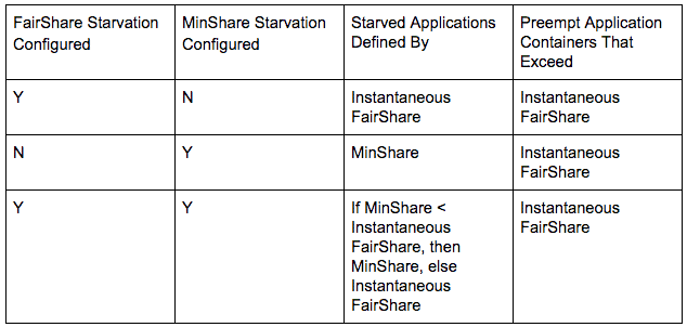

    Best Practice for Configuring Starvation
    Configuring FairShare starvation is recommended. In general, configuring MinShare Starvation or minimum resources is not recommended since it adds significant complexity (and confusion) when debugging preemption issues without much added benefit:
    • When MinShare starvation occurs, containers in queues exceeding MinShare but not exceeding FairShare cannot be preempted.
    • MinShare-starved resources are not distributed equally to applications in a queue, but in demand order. This behaviour is different from how FairShare-starved resources are distributed.
    • If a minimum resource value in a queue is greater than its FairShare value, the minimum resource value becomes queue’s FairShare. This effectively reduces the FairShare of other queues.

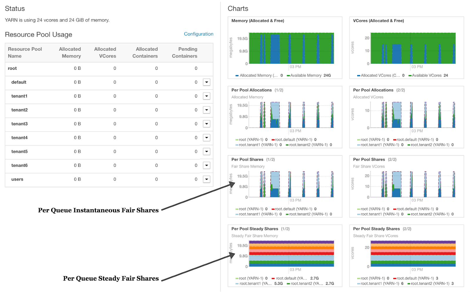

    Examining FairShare and Queue Metrics
    In Cloudera Manager, use the Resource Pools tab under YARN service to observe pool Steady and Instantaneous FairShare values as well as actual resource allocations.
    Tools for Preemption Tuning
    Cloudera Manager also monitors other metrics related to queues:
    • Under Cloudera Manager Reports page, click Clusters > ClusterName > Reports > Historical Applications By YARN Pool.
    • Use tsquery to retrieve and plot YARN pool metrics.

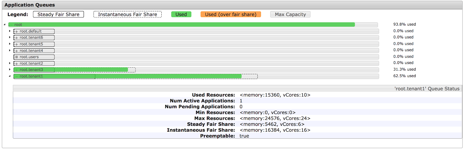

    Current applications, queues, and FairShares can also be examined through the Scheduler section of ResourceManager’s web interface. Please note that the usage bars as displayed in the ResourceManager web interface only show the memory usage and not the vCores usage.
