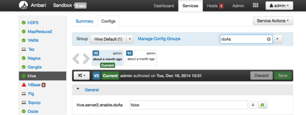

    Step 1. Hive Configuration
    In Ambari –> Hive-> Config, ensure the hive.server2.enable.doAs is set to “false”. What this means is that Hiveserver2 will run MR jobs in HDFS as “hive” user. Permissions in HDFS files related to Hive can be given only to “hive” users, and no analyst would be able to access HDFS files directly.
    Hive Configuration

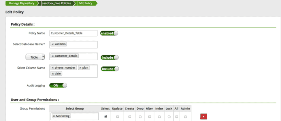

    With Ranger installed, you can configure a policy at a column level as shown below:
    Ranger configuration
    In this example, the marketing group has only access to “phone number”, “plan” and “date” columns in the “customer_details” table.

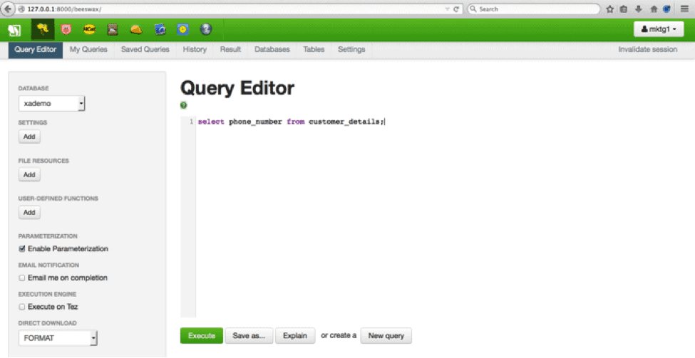

    Step 3.Run a query
    You can use Hue or Beeline to run a query against this table. In this example from the sandbox, we have used user “mktg1” to run the query against this table.

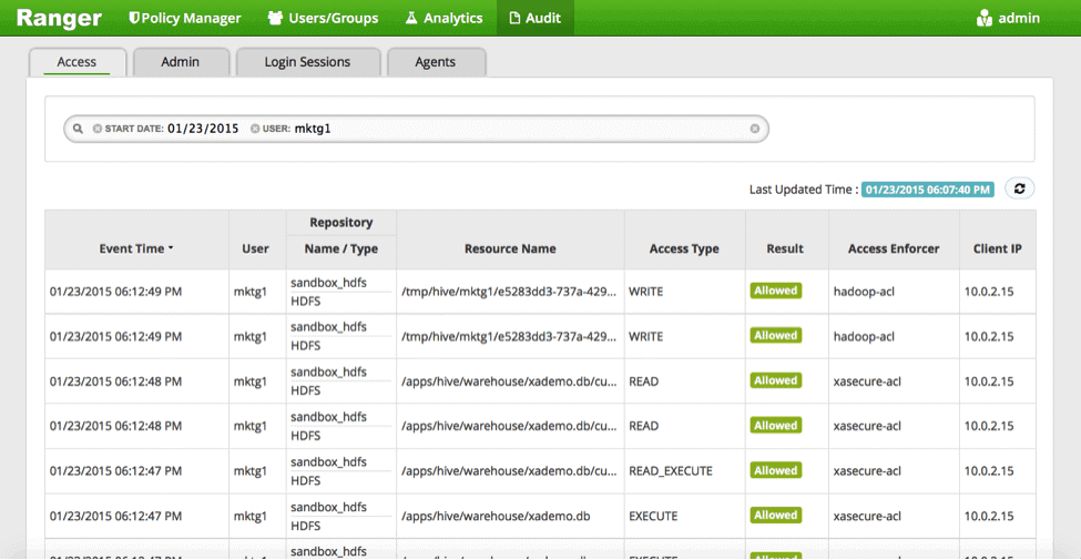

    After successfully running the query, check the audit logs in Ranger
    You will see the query running in Hive as the original user (“mktg1” in this case), while the related tasks in HDFS will be executed as the “hive” user.
    With Ranger enabled, the only way data analysts can view data would be through Hive and the access in Hive would be controlled at the column level. Administrators who need access at HDFS level can be given permissions through Ranger policies for HDFS or through HDFS ACLs.

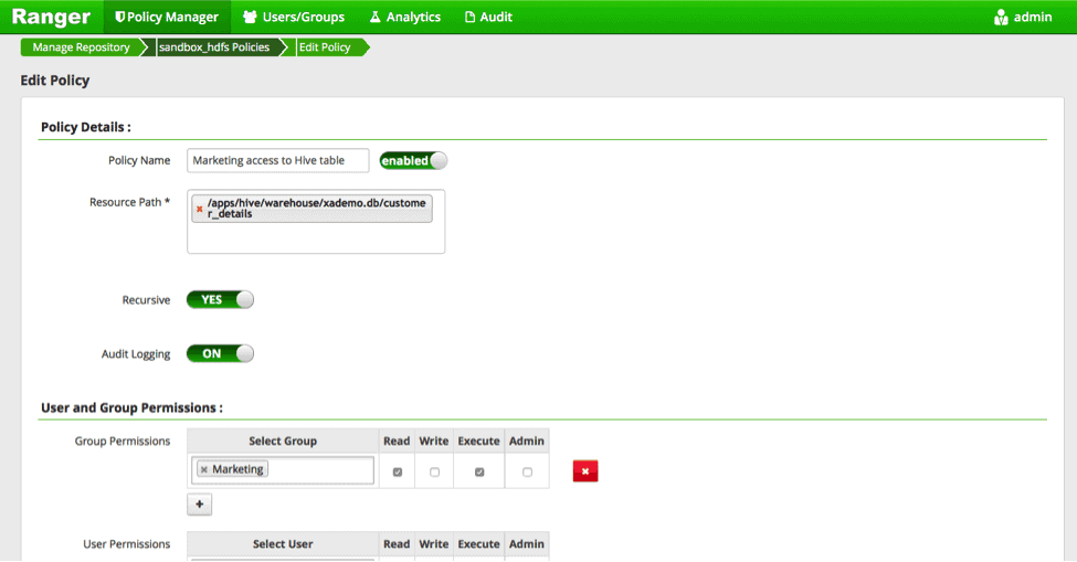

    Step 2. In Ranger, within HDFS, create permissions for files pertaining to hive tables
    In the example below, we will be giving the marketing team “read” permission to the file corresponding to the Hive table “customer_details”
    The users can access data through HDFS commands as well.

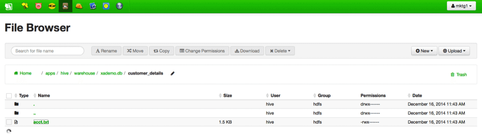

    1. First identify the files corresponding to tables in Hive. You can look through the directory /apps/hive/warehouse
    2. Set permissions for this folder in Ranger -> HDFS Policies

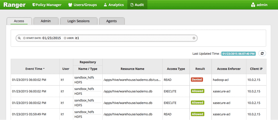

    hive> drop table customer_details;
    FAILED: SemanticException Unable to fetch table customer_details. java.security.AccessControlException: Permission denied: user=it1, access=READ, inode=”/apps/hive/warehouse/xademo.db/customer_details”:hive:hdfs:drwx——
    The action drop table is denied due to lack of permission at the HDFS level. It can be verified in the Ranger audit logs:
