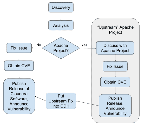

    An overview of the process looks like this flowchart:

    In the Analysis phase, engineers spring into action to determine the severity, impact, and repercussions of the issue. The overall severity of security vulnerabilities depends primarily on two factors: the ease of exploitation and the severity of the vulnerability. For example, if an exploit can be performed remotely (in other words, over the network) and the result is that the attacker gets access to sensitive data, that’s about as bad as it can get. If an exploit is really difficult and yields little new information, that’s a very mild issue. Most exploits lie somewhere in between.
    If the vulnerability is in an Apache project, the actions we take move to the upstream community. The Apache Software Foundation has a well established process in place already that specifies how projects handle security issues; the outline of this process is roughly:
    1. Deal with the issue completely on a private mailing list and not in a public JIRA.
    2. Agree on a fix and implement it.
    3. Request a CVE number (more on this in a bit).
    4. Commit the fix, publish a release with the fix, and then report the fix publicly.
    Once this process is complete in the upstream community, Cloudera will incorporate the fix into our software, publish a release with the fix, and publicly announce the issue and fix.
    If the vulnerability is in Cloudera-controlled software such as Cloudera Manager, the process is basically the same except that discussion is kept privately inside the company.
    Frequently this process is complicated by the scope of the security vulnerability. One good example was the POODLE vulnerability in SSLv3. This vulnerability basically made SSLv3 obsolete overnight, and software needed to turn off support for it – and this had to happen with basically every component in the system. (Imagine the right half of the flowchart above being repeated a dozen times!)
