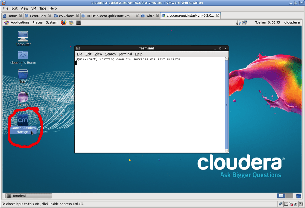

    Before you start the QuickStart VM, increase the memory allocation to 8GB RAM and increase the number of CPUs to two. You can get by with a little less RAM, but we will have everything including the Kerberos server running on one node.
    Start up the VM and activate Cloudera Manager as shown here:
    Give this script some time to run, it has to restart the cluster.

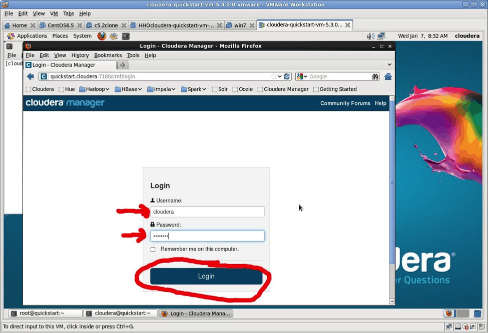

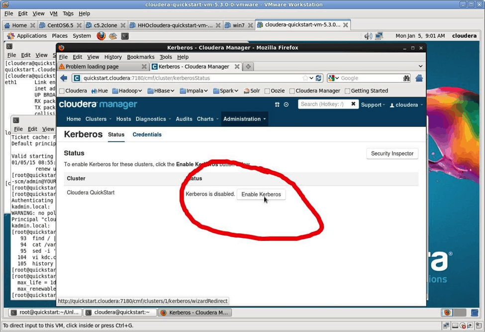

    To start, log into Cloudera Manager by going to http://quickstart.cloudera:7180 in your browser. The userid is cloudera and the password is cloudera. (Almost needless to say but never use “cloudera” as a password in a real-world setting.)

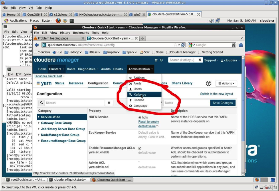

    There are lots of productivity tools here for managing the cluster but ignore them for now and head straight for the Administration > Kerberos wizard as shown in the next screenshot.

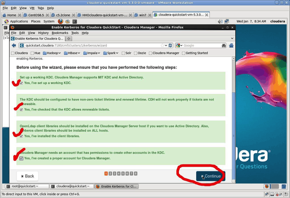

    Click on the “Enable Kerberos” button.

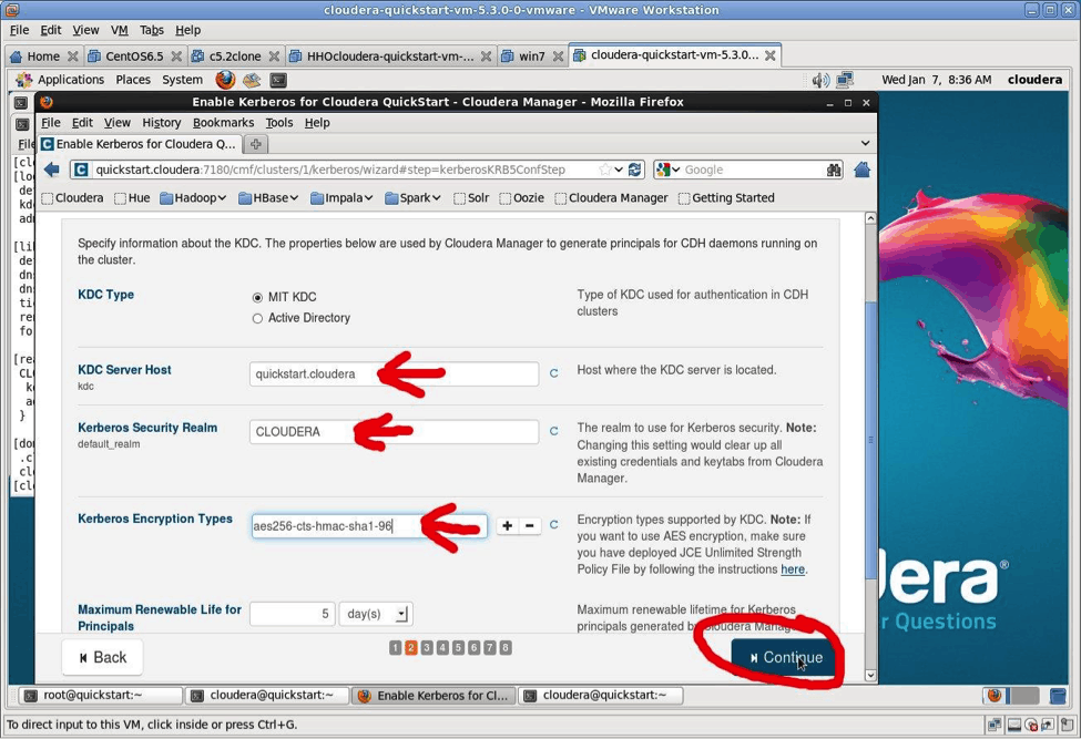

    The four checklist items were all completed by the script you’ve already run. Check off each item and select “Continue.”
    The Kerberos Wizard needs to know the details of what the script configured. Fill in the entries as follows:
    • KDC Server Host: quickstart.cloudera
    • Kerberos Security Realm: CLOUDERA
    • Kerberos Encryption Types: aes256-cts-hmac-sha1-96
    Click “Continue.”

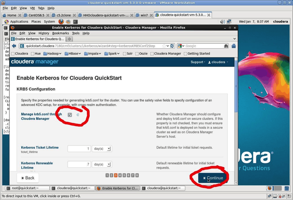

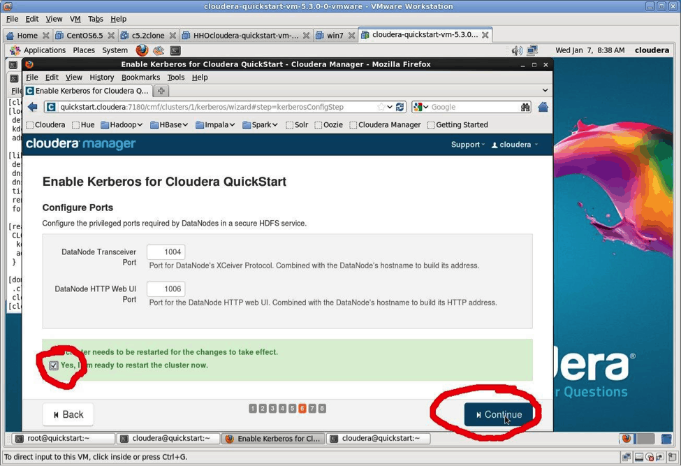

    Do you want Cloudera Manager to manage the krb5.conf files in your cluster? Remember, the whole point of this blog post is to make Kerberos easier. So, please check “Yes” and then select “Continue.”

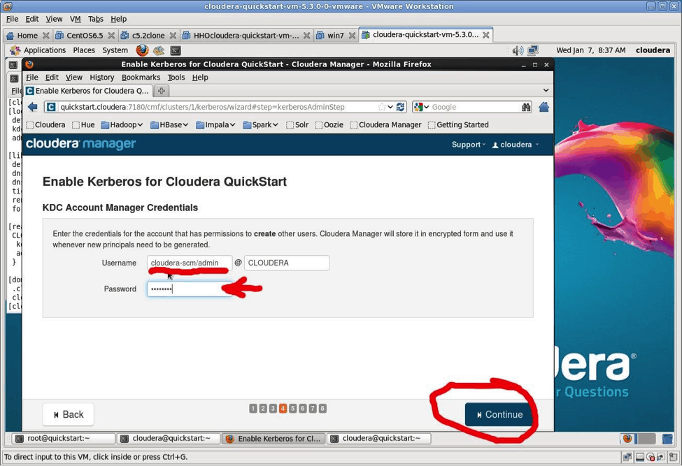

    The Kerberos Wizard is going to create Kerberos principals for the different services in the cluster. To do that it needs a Kerberos Administrator ID. The ID created is: cloudera-scm/admin@CLOUDERA.
    The screen shot shows how to enter this information. Recall the password is: cloudera.

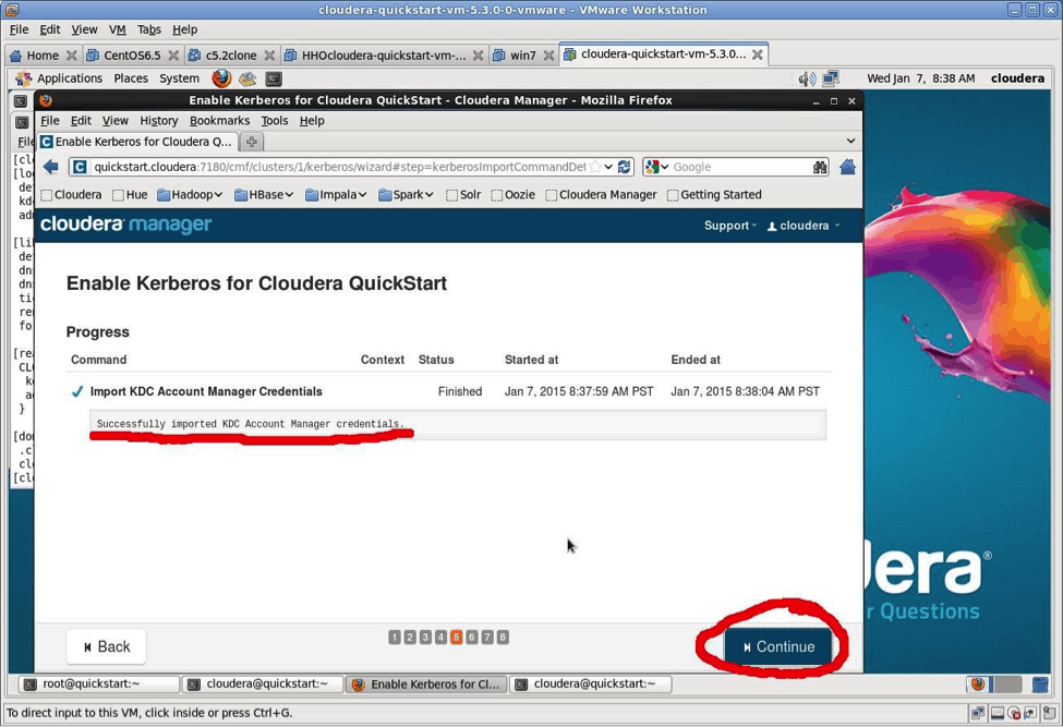

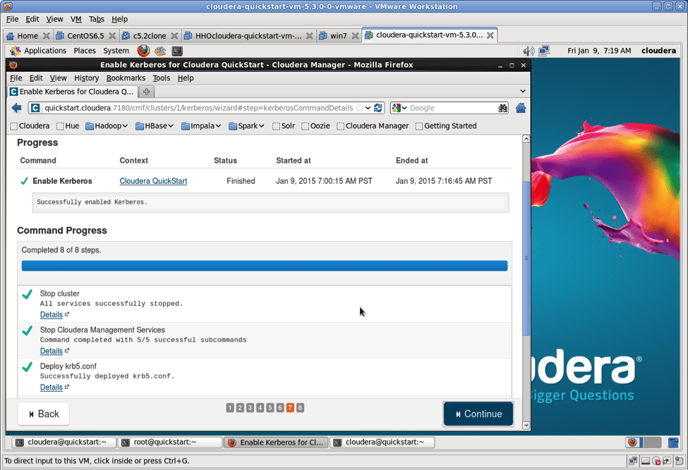

    The next screen provides good news. It lets you know that the wizard was able to successfully authenticate.
    OK, you’re ready to let the Kerberos Wizard do its work. Since this is a VM, you can safely select “I’m ready to restart the cluster now” and then click “Continue.” You now have time to go get a coffee or other beverage of your choice.
    How long does that take? Just let it work.

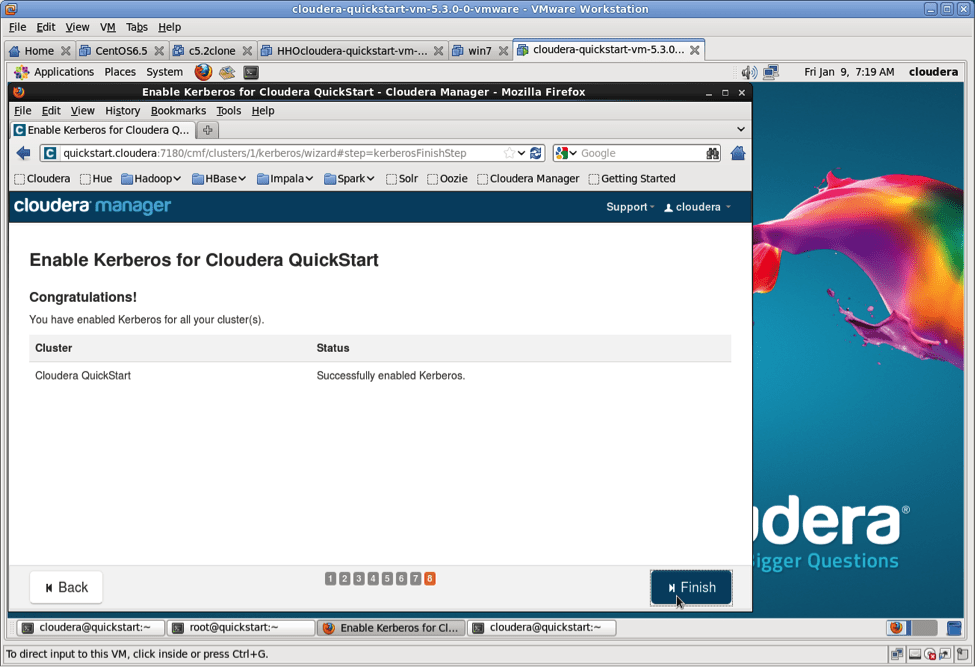

    Congrats, you are now running a Hadoop cluster secured with Kerberos.

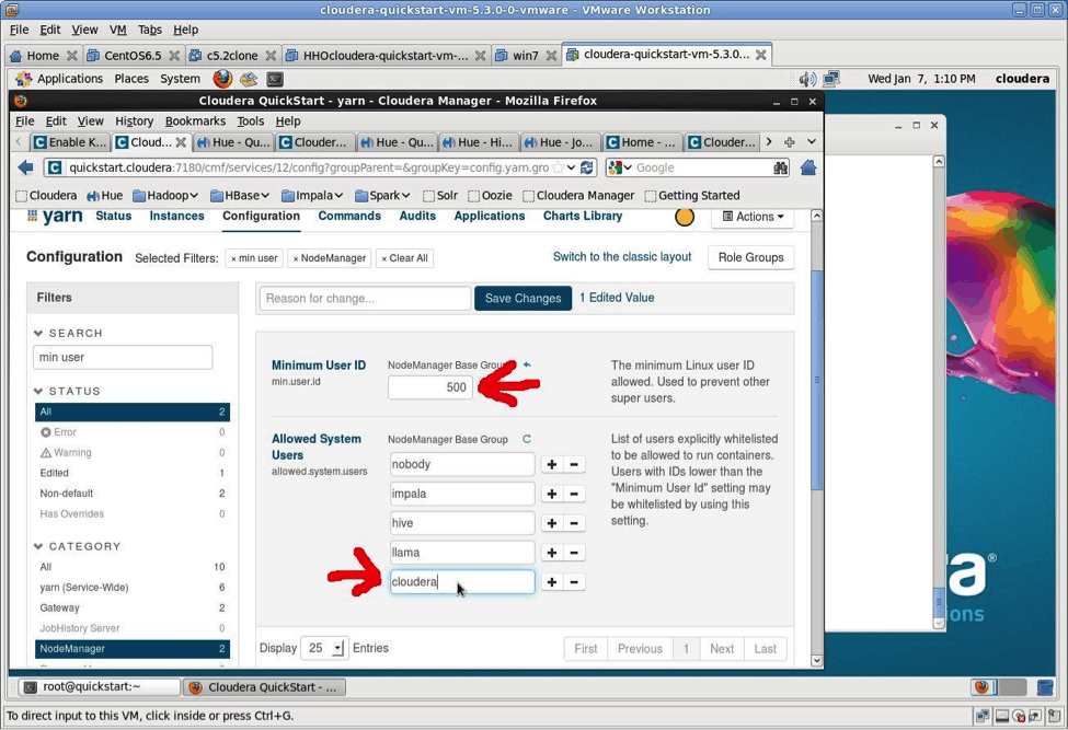

    The min.user parameter needs to be fixed per the message below:
    Requested user cloudera is not whitelisted and has id 501, which is below the minimum allowed 1000
    Must kinit prior to using cluster
    This is the error message you get without fixing min.user.id:
    Application initialization failed (exitCode=255) with output:
    Save the changes shown above and restart the YARN service. Now validate that the cloudera user can use the cluster:
