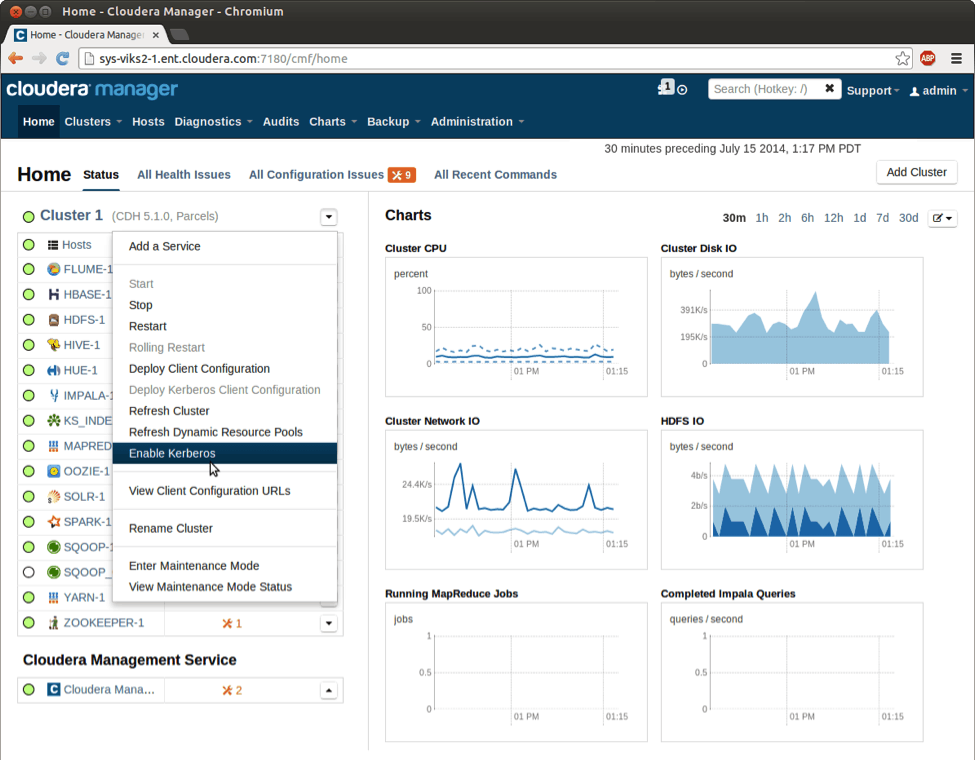

    The wizard is triggered by going to the Actions menu of your cluster on the Home page of the Cloudera Manager UI as shown below.
    Triggering the Enable Kerberos Wizard

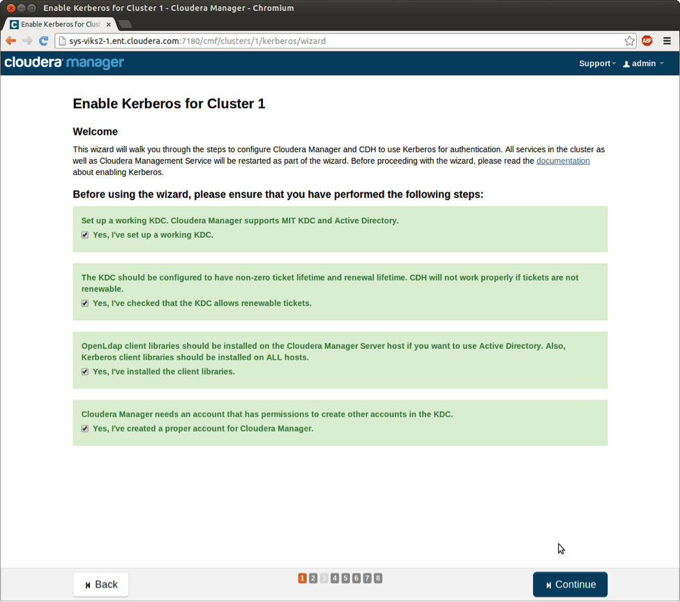

    The first page of the wizard contains a checklist to inform you about the prerequisites of setting up a Kerberized cluster:
    The Welcome Page
    The Welcome Page

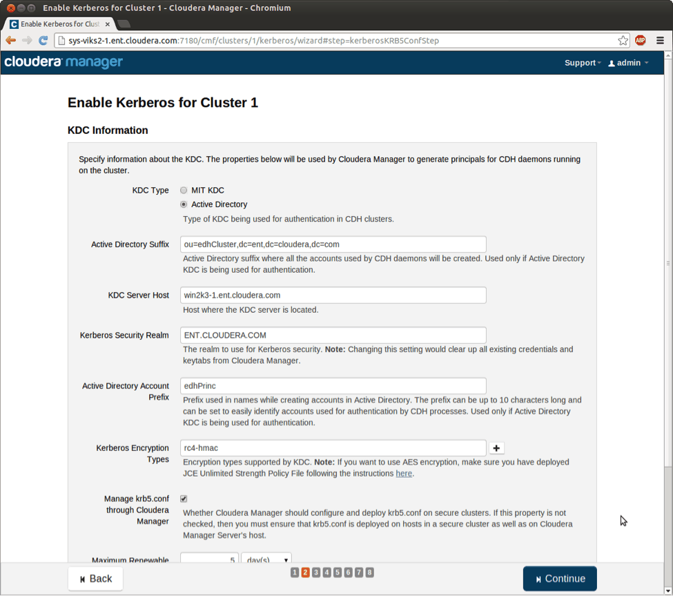

    The next page has fields to provide information about your KDC. In this example, I’ve selected Active Directory as the KDC type and specified the hostname of the domain controller in KDC Server Host field. Additionally, you’d need to provide the OU (ou=edhCluster,dc=ent,dc=cloudera,dc=com, for example) where all the accounts will be created and the Kerberos realm you would like to use for the cluster. If you want Cloudera Manager to generate and deploy Kerberos client configs (krb5.conf) on your cluster instead of doing it manually, you should check “Manage krb5.conf” through Cloudera Manager. You can also optionally provide an account prefix that will be added to all the accounts created by Cloudera Manager to easily identify them. In the example below, the prefix is set as edhCluster.
    Enter KDC information

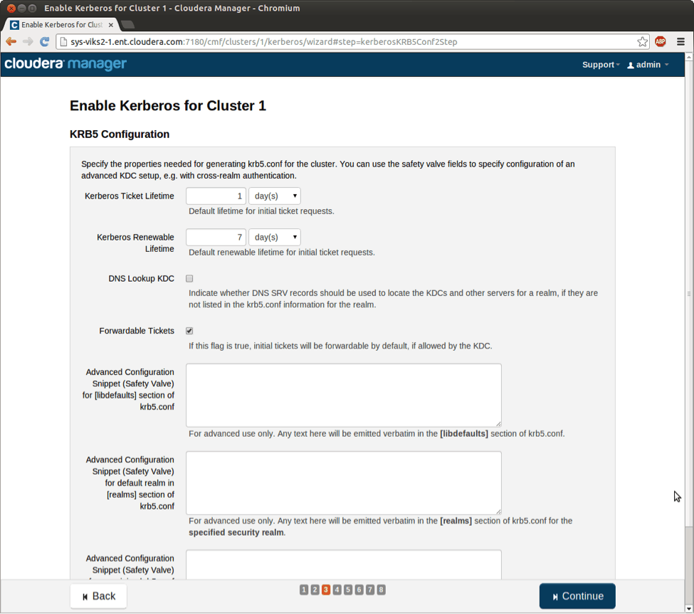

    The advanced Kerberos client configuration page is next, which you’d typically use if you have a complex setup that involves cross-realm trust. If you are going to have a simple direct-to-Active Directory setup only, you can move on to the next section.
    Advanced krb5.conf configuration (can be skipped for Direct-to-AD setup)

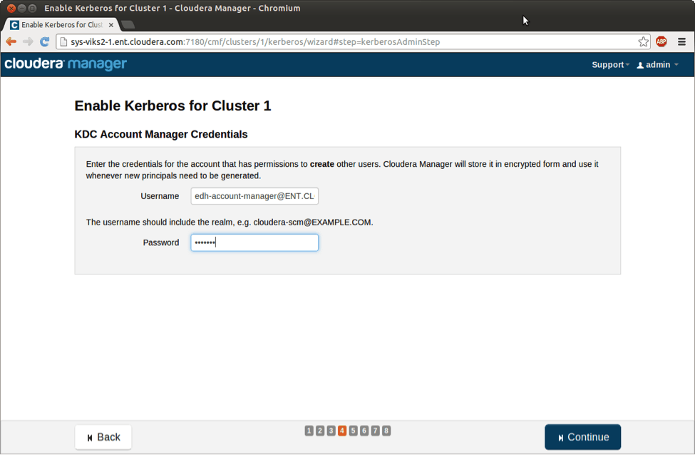

    Next, you are going to enter the username and password for the Account Manager user (edh-account-manager) you created in Active Directory before entering the wizard. Cloudera Manager will generate an encrypted keytab with the credentials and use it whenever it needs to create new accounts.
    Enter Account Manager credentials

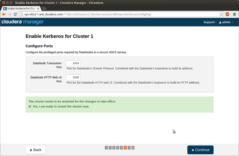

    The final piece of information you need to provide is the privileged ports that are needed by HDFS DataNodes in a secure cluster. The wizard recommends defaults that you can use.
    Enter privileged ports used by DataNodes

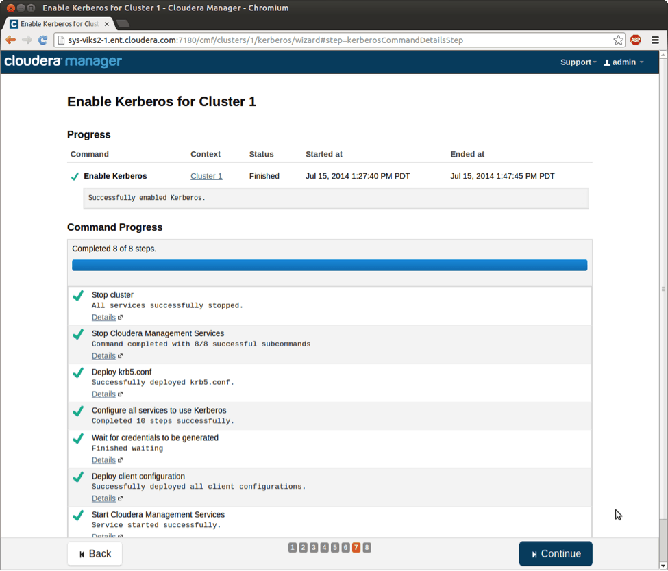

    That’s it! Now Cloudera Manager starts a workflow that would run all the steps involved in enabling Kerberos for the cluster as shown below. Once the workflow is finished, only the users present in Active Directory (in any OU) will be able to authenticate to the cluster.
    The final workflow
    The final workflow

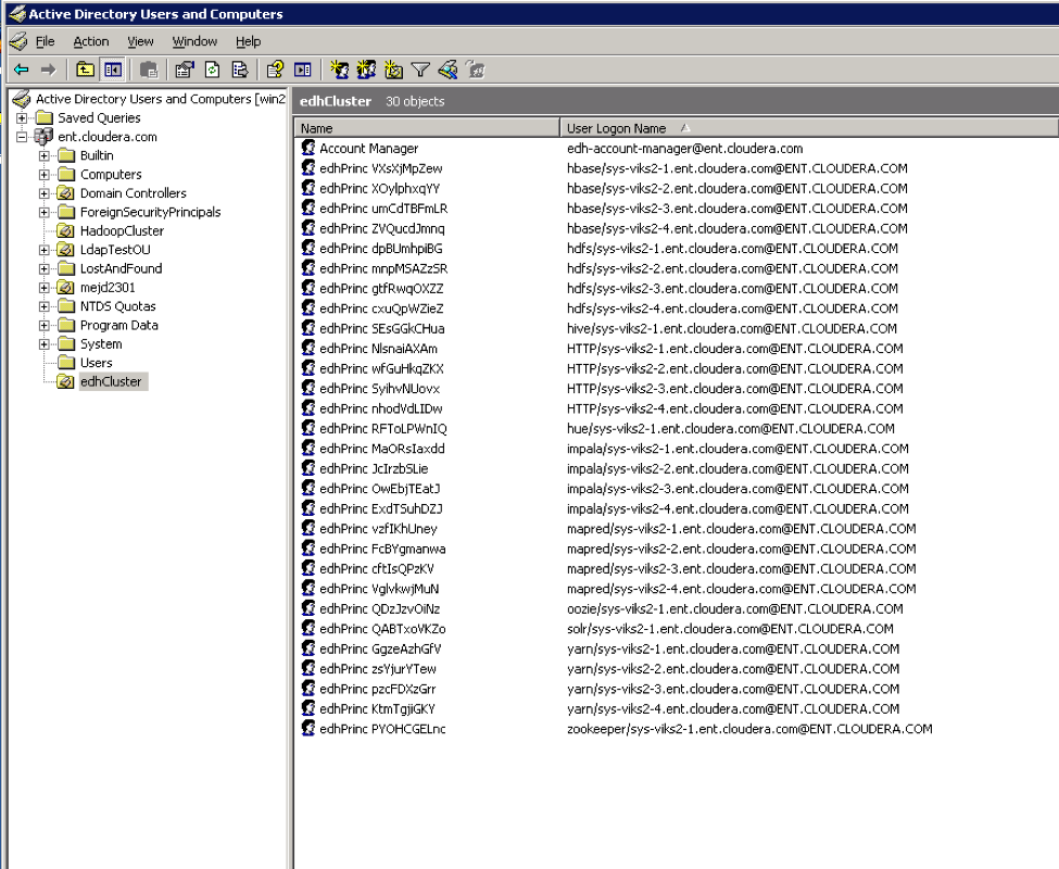

    Below is a screenshot of the OU after Cloudera Manager has created all the accounts needed by these processes. As you can see, all the auto-generated accounts have the prefix edhCluster in the display names. One important point to note is that Cloudera Manager sets randomly generated passwords for all the accounts. These passwords are also stored in encrypted keytabs and used when starting a process on the cluster (that is, the passwords themselves are unknown even to Cloudera Manager once the account is created).
    Accounts created by Cloudera Manager
    Once the initial setup has been done for enabling Kerberos for the cluster, Cloudera Manager will also automatically create any new accounts that are needed when new hosts are added to your cluster or when you’re adding a new service.
