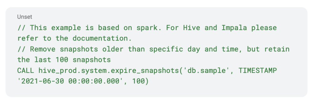

    Solution: expire snapshots
    We can expire old snapshots using expire_snapshots
    Example based on spark

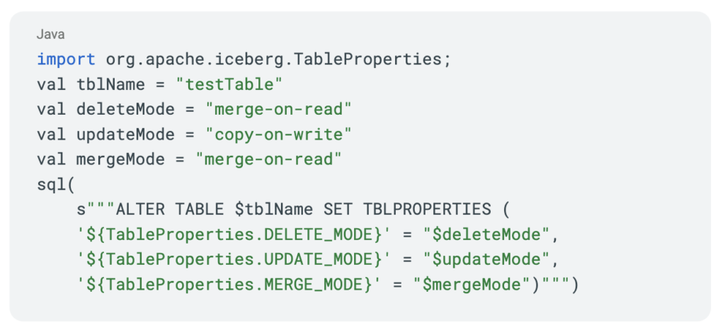

    merge-on-read vs copy-on-write
    Since Iceberg V2, whenever existing data needs to be updated (via delete, update, or merge statements), there are two options available: copy-on-write and merge-on-read. With the copy-on-write option, the corresponding data files of a delete, update, or merge operation will be read and entirely new data files will be written with the necessary write modifications. Iceberg doesn’t delete the old data files. So if you want to query the table before the modifications were applied you can use the time travel feature of Iceberg. In a later blog, we will go into details about how to take advantage of the time travel feature. If you decided that the old data files are not needed any more then you can get rid of them by expiring the older snapshot as discussed above.
    With the merge-on-read option, instead of rewriting the entire data files during the write time, simply a delete file is written. This can be an equality delete file or a positional delete file. As of this writing, Spark doesn’t write equality deletes, but it is capable of reading them. The advantage of using this option is that your writes can be much quicker as you are not rewriting an entire data file. Suppose you want to delete a specific user’s data in a table because of GDPR requirements, Iceberg will simply write a delete file specifying the locations of the user data in the corresponding data files where the user’s data exist. So whenever you are reading the tables, Iceberg will dynamically apply those deletes and present a logical table where the user’s data is deleted even though the corresponding records are still present in the physical data files.
    We enable the merge-on-read option for our customers by default. You can enable or disable them by setting the following properties based on your requirements. See Write properties.
    Iceberg Table Properties

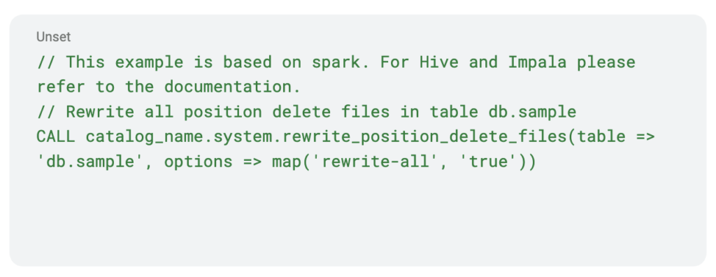

    Solution: rewrite position deletes
    For position delete files, compacting the position delete files mitigates the problem a little bit by reducing the number of delete files that need to be read and offering faster performance by better compressing the delete data. In addition the procedure also deletes the dangling deletes.
    Rewrite position delete files
    Iceberg provides a rewrite position delete files procedure in Spark SQL.

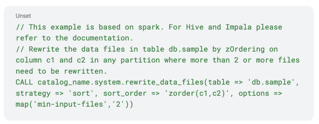

    Solution: rewrite data files
    To address the small files problem and delete files problem, Iceberg provides a feature to rewrite data files. This feature is currently available only with Spark. The rest of the blog will go into this in more detail. This feature can be used to compact or even expand your data files, incorporate deletes from delete files corresponding to the data files that are being rewritten, provide better data ordering so that more data could be filtered directly at read time, and more. It is one of the most powerful tools in your toolbox that Iceberg provides.
    RewriteDataFiles
    Iceberg provides a rewrite data files procedure in Spark SQL.
    See RewriteDatafiles JavaDoc to see all the supported options.
    Now let’s discuss what the strategy option means because it is important to understand to get more out of the rewrite data files procedure. There are three strategy options available. They are Bin Pack, Sort, and Z Order. Note that when using the Spark procedure the Z Order strategy is invoked by simply setting the sort_order to “zorder(columns…).”
