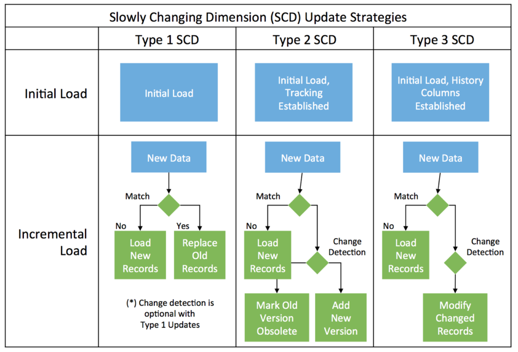

    Hive- Overview of SCD Strategies
    Hive Overview of SCD Strategies

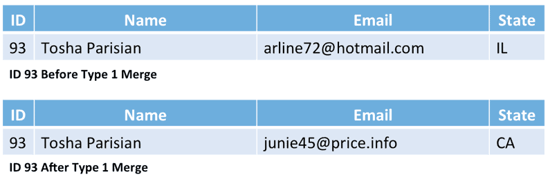

    Let’s see what this does for a particular record that changes, Record 93:
    ID 93 After type 1 merge
    The important things to emphasize here is that all inserts and updates are done in a single pass with full atomicity and isolation to upstream SQL queries, plus automated rollback if failures occur. Guaranteeing all these properties with legacy SQL-on-Hadoop approaches is so difficult that hardly anyone has put them into practice, but Hive’s MERGE makes it trivial.

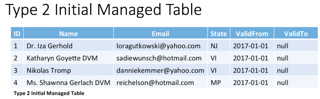

    Type 2 updates allow full version history and tracking by way of extra fields that track the current status of records. In this example we will add start and end dates to each record. If the end date is null, the record is current. Again, check out the GitHub for details of how to stage data in.
    Type 2 initial managed table

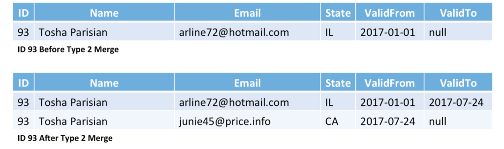

    Let’s see what this does to Record 93.
    ID 93 After type 2 merge
    We have simultaneously and atomically expired the first record while adding a new record with up-to-date details, allowing us to easily track full history for our dimension table.

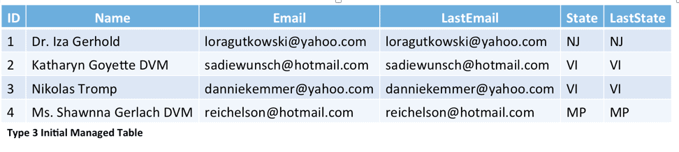

    For this example we will only track the current value and the value from one version prior, and will track the version in the same row. Here’s a sample:
    Type 3 initial managed table

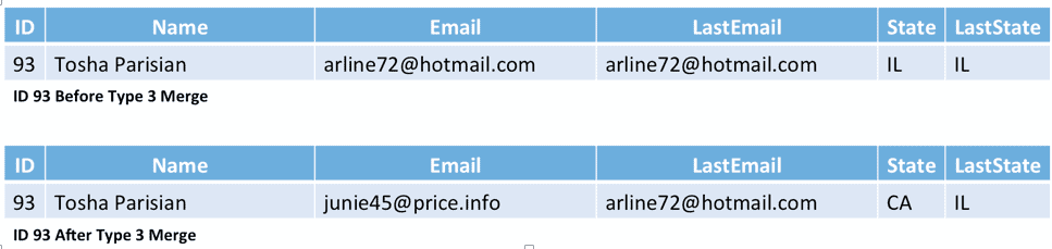

    You can see this code is very simple relative to Type 2, but only offers limited history. Let’s see the before and after for Record 93:
    ID 93 After type 3 merge
