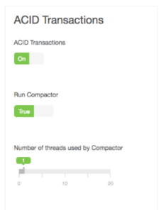

    With HDP 2.6 there are two things you need to do to allow your tables to be updated.
    First: you need to configure you system to allow Hive transactions. In Ambari this just means toggling the ACID Transactions setting on.
    ACID Transactions

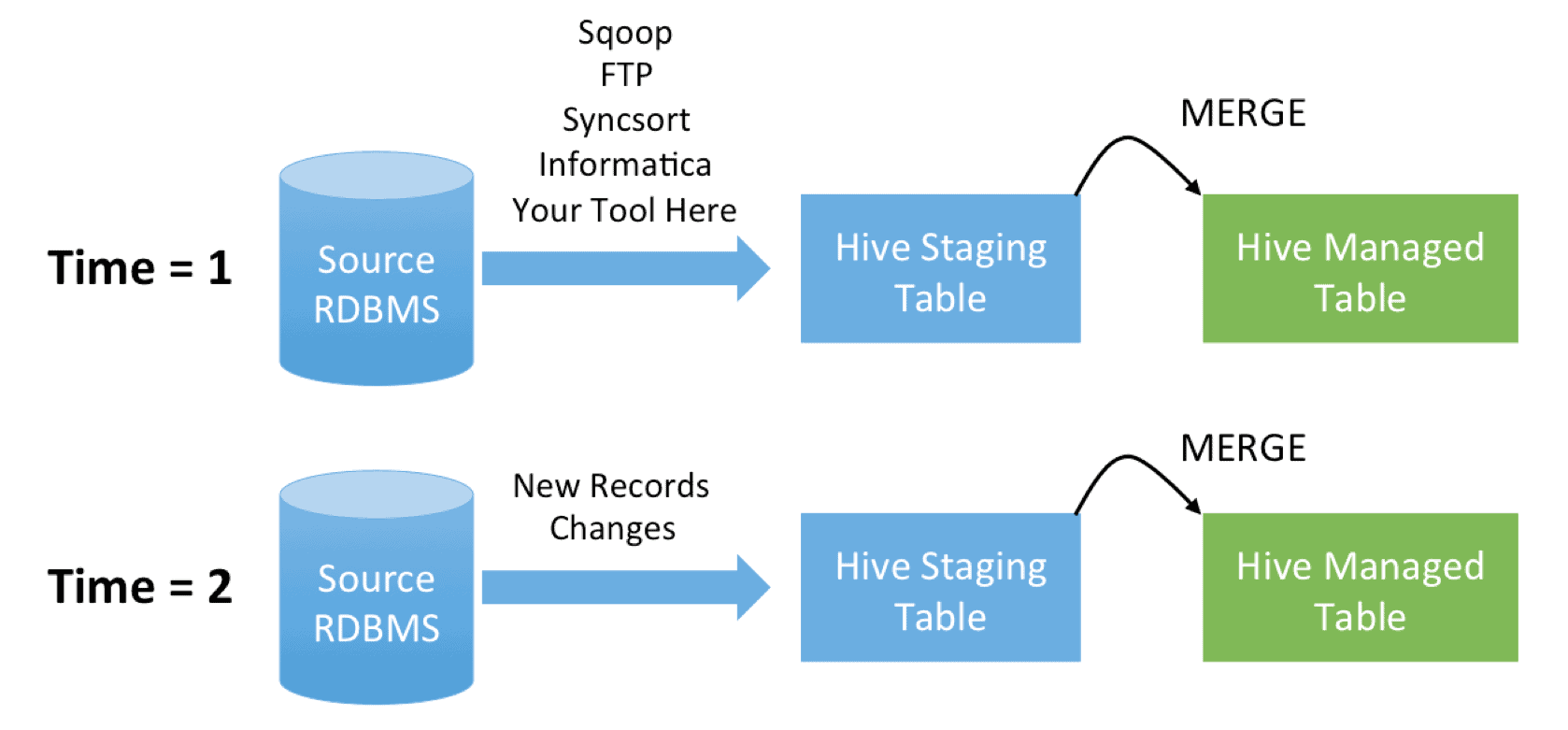

    Use Case 1: Hive Upserts
    Suppose you have a source database you want to load into Hadoop to run large-scale analytics. Records in the source RDBMS are constantly being added and modified, and there’s no log to help you understand which records have changed. Instead to keep things simple you just do a full dump every 24 hours and update the Hadoop side to make it a mirror image of the source side.
    Hive Upserts
    Let’s create our managed table as follows:

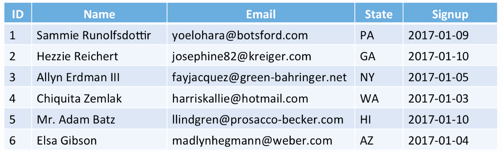

    Suppose our source data at Time = 1 looks like this:
    Source data at Time = 1
    And the refreshed load at Time = 2 looks like this:
    Source data at Time = 2
    Upsert combines updates and inserts into one operation, so you don’t need to worry about whether records existing in the target table or not. MERGE is designed with this use case in mind and the basic usage is extremely simple:

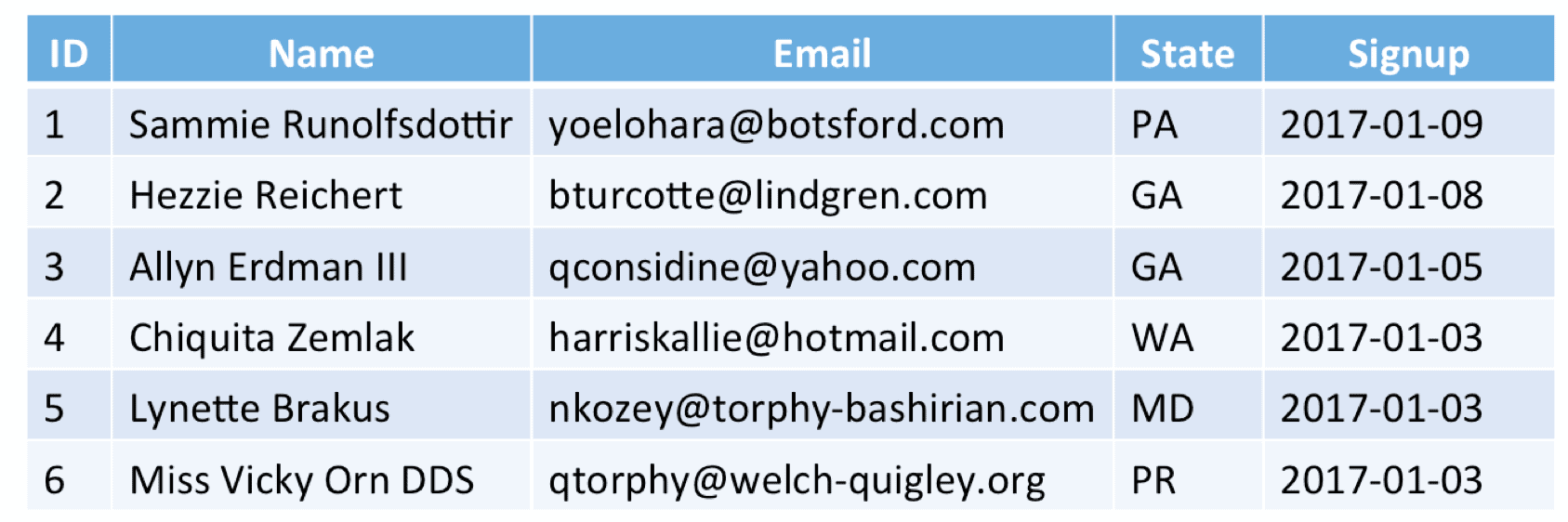

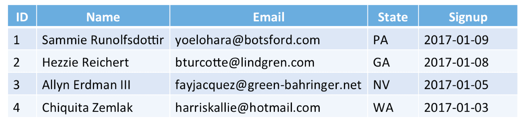

    Suppose our initial data looks like this:
    Initial data
    And our second load looks like this:
    Second data
    Notice that ID 2 has the wrong Signup date at T = 1, so is in the wrong partition in the Hive table. This needs to be updated somehow so that ID 2 is removed from partition 2017-01-08 and added to 2017-01-10.

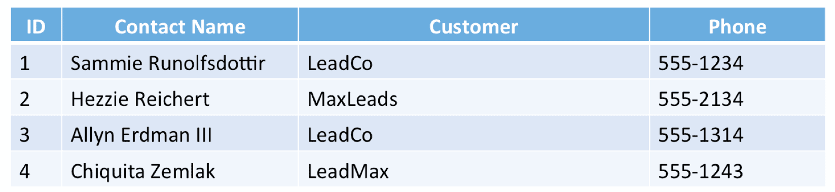

    Use Case 3: Mask or Purge Hive Data.
    Let’s say your security office comes to you one day and says that all data from a particular customer needs to be masked or purged. In the past you could have spent hours or days re-writing affected partitions.
    Suppose our contacts table looks like this:
    contacts table
    And we created our table as follows:
    create table contacts
     (id int, name string, customer string, phone string)
     clustered by (id) into 2 buckets stored as orc
    tblproperties("transactional"="true");
    The security office approaches us, asking for various actions:
    Example: Mask all contact phone numbers from customer MaxLeads
    Here we use Hive’s built-in masking capabilities (as of HDP 2.5 or Apache Hive 2.1)
    update contacts set phone = mask(phone) where customer = 'MaxLeads';
    Example: Purge all records from customer LeadMax
    delete from contacts where customer = 'LeadMax';

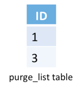

    Example: Purge records matching a given list of keys.
    Suppose the security office gave us a CSV with certain keys and asked us to delete records matching those keys. We load the security office’s CSV into a table and get the list of keys using a subquery.
    delete from contacts where id in ( select id from purge_list );
