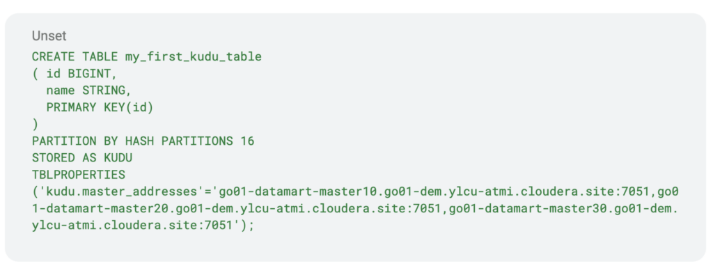

    You can also potentially use Cloudera Data Engineering to ingest data into Kudu DH cluster, thereby using the DH cluster just for storage. Advanced users can also use the TBLPROPERTIES to set the Kudu cluster details to query data from any Kudu DH cluster of choice.
    Kudu DH cluster query
