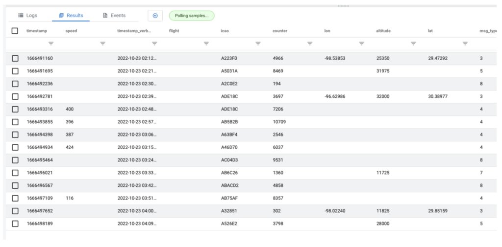

    To better illustrate how MVs work, let’s execute a simple SQL query to retrieve all of the data from our stream.
    SELECT * FROM airplanes;
    The creation of the “airplanes” table has been omitted, but suffice it to say airplanes is a virtual table we have created, which is fed by a stream of ADS-B data flowing through a Kafka topic. Please check our documentation to see how that’s done. The query above will generate output like the following:
    airplanes query result
    As you can see from the output, there are all kinds of interesting data points. In our example let’s focus on altitude.

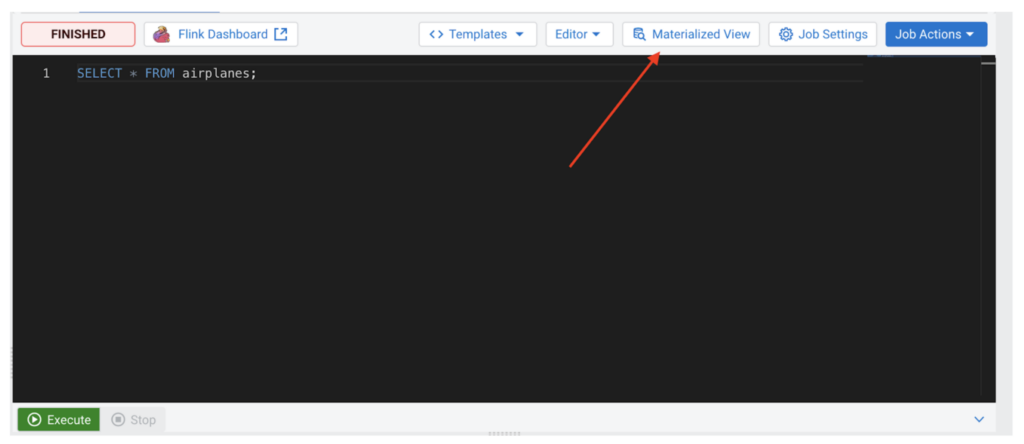

    From the SSB Console, click on the “Materialized View” button on the top right:

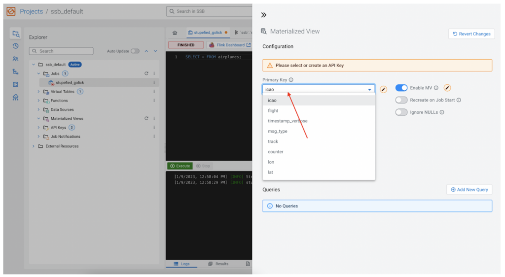

    Primary key
    Every MV requires a primary key, as this will be our primary key in the underlying relational database as well. The key is one of the fields returned by the SSB SQL query, and it is available from the dropdown. In our case we will choose icao, because we know that icao is the identification number for each plane, so it is a perfect fit for the primary key.
    Primary Key: icao

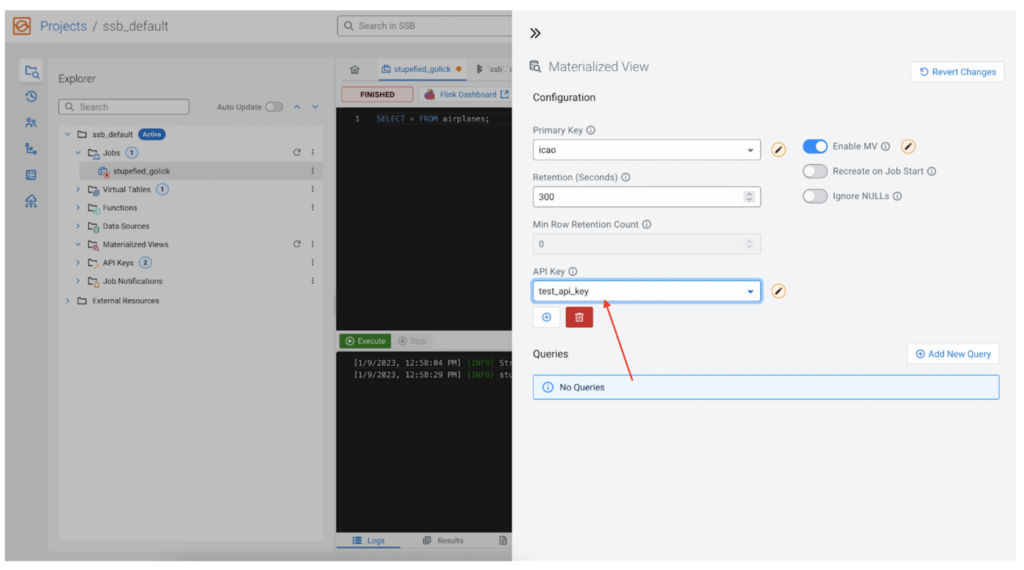

    API key
    As mentioned earlier, every MV is associated with a REST API. The REST API endpoint must be protected by an API Key. If none has been added yet, one can be created here as well.

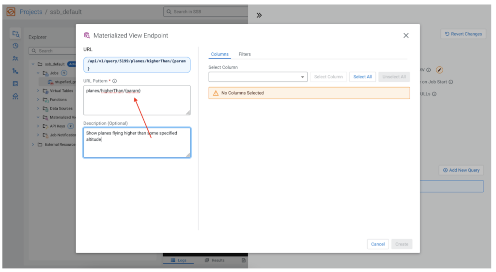

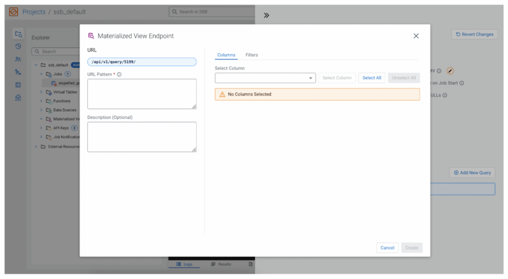

    Clicking on the “Add New Query” button opens a pop-up that allows us to configure the REST API endpoint, as well as selecting the data we would like to query.
    Add New Query
    As we said earlier, we are interested in the plane’s altitude, but let’s also add the ability to filter the field altitude when calling the REST API. Our MV will be able to only show planes that are flying higher than some user specified altitude (i.e., show planes flying higher than 10,000 feet). In that case in the “URL Pattern” box we could enter:
    planes/higherThan/{param}
    Note the {param} value. The URL pattern can take parameters that are specified inside curly brackets. When we retrieve data for the MV, the REST API will map these parameters in our filters, so the user calling the endpoint can set the value. See below.

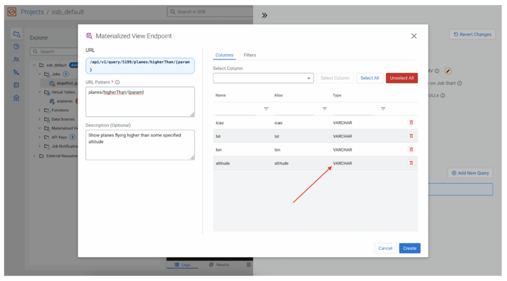

    Now it is time to select what data to collect as part of our MV. The data fields we can choose come from the initial SSB SQL query we wrote, so if we said SELECT * FROM airplanes; the “Select Columns” dropdown will have things like flight, icao, lat, counter, altitude, etc. For our example let’s choose icao, lat, lon and altitude.
    Materialized View Endpoint - Columns
    Oops

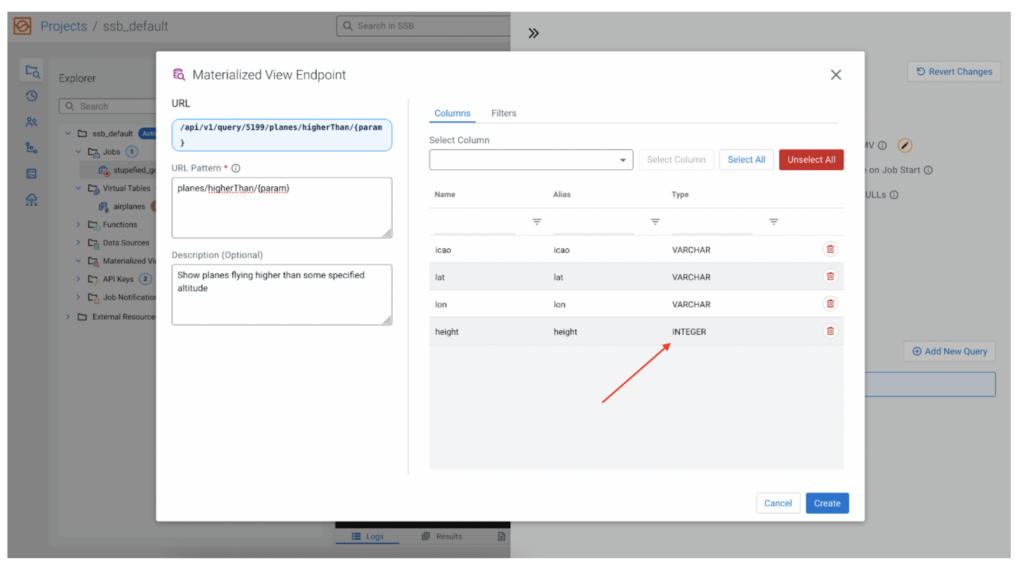

    We have a problem. The data fields in the stream, including the altitude, are all of VARCHAR type, making it infeasible to filter for numeric data. We need to make a simple change to our SQL and convert the altitude into an INT, and call it height, to differentiate it from the original altitude field. Let’s change the SQL to the following:
    SELECT *, CAST(altitude AS INT) AS height FROM airplanes;
    Now we can replace altitude with height, and use that to filter.
    Corrected URL Materialized View Endpoint

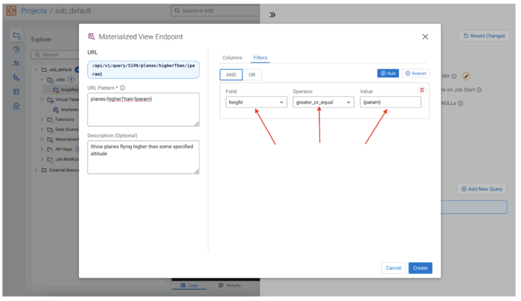

    Filtering
    Now to filter by height we need to map the parameter we previously created ({param})  to the height field. By clicking on the “Filters” tab, and then the “+ Rule” button, we can add our filter.
    Materialized View Endpoint - Filtering
    For the “Field” we choose height, for the “Operator” we want “greater_or_equal,” and for the “Value” we use the {param} we used in the REST API endpoint. Now the MV query will filter the rows by the value of height being greater than the value that the user would give to {param} when issuing the REST request, for example:
    https://<host>/…/planes/higherThan/10000
    That would output something similar to the following:
    [{"icao":"A28947","lat":"","lon":"","height":"30075"}]
