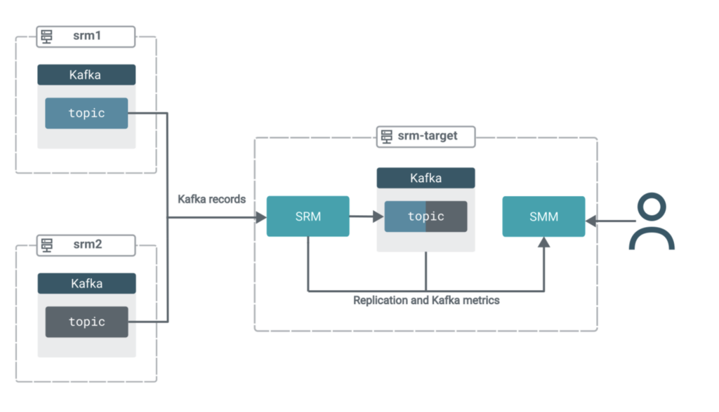

    Scenario overview
    Scenario overview
    In this scenario you have three clusters. All clusters contain Kafka. Additionally, the target cluster (srm-target) has SRM and SMM deployed on it.
    The SRM service on srm-target is used to pull Kafka data from the other two clusters. That is, this replication setup will be operating in pull mode, which is the Cloudera-recommended architecture for SRM deployments.
    In pull mode, the SRM service (specifically the SRM driver role instances) replicates data by pulling from their sources. So rather than having SRM on source clusters pushing the data to target clusters, you use SRM located on the target cluster to pull the data into its co-located Kafka cluster.Pull mode is recommended as it is the deployment type that was found to provide the highest amount of resilience against various timeout and network instability issues. You can find a more in-depth explanation of pull mode in the official docs.
    The records from both source topics will be aggregated into a single topic on the target cluster. All the while, you will be able to use SMM’s powerful UI features to monitor and verify what’s happening.

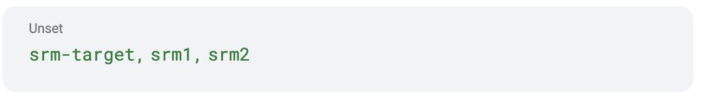

    1. Specify all cluster aliases with “Streams Replication Manager Cluster” alias.
    The property contains a comma-delimited list of all cluster aliases. That is, all  aliases you previously added to the Streams Replication Manager Co-located Kafka Cluster Alias and  External Kafka Accounts properties. Set this to:

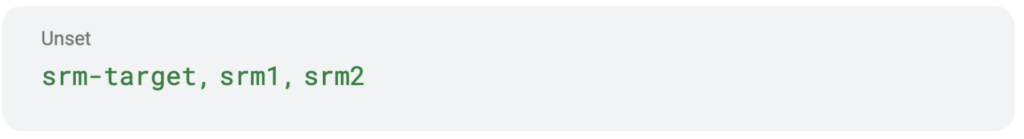

    1. Specify the driver role target with Streams Replication Manager Driver Target Cluster.

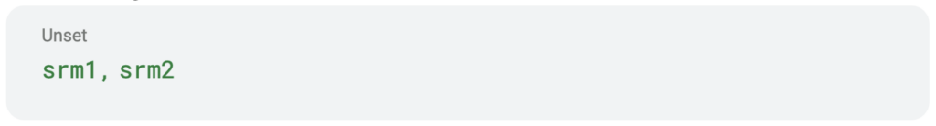

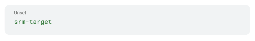

    1. Specify service role targets with Streams Replication Manager Service Target Cluster.
    This property specifies the cluster that the SRM service role will gather replication metrics from (i.e. monitor). In pull mode, the service roles must always target their co-located cluster. Set this to:

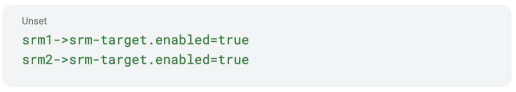

    1. Specify replications with Streams Replication Manager's Replication Configs.
    This property is a jack-of-all-trades and is used to set many SRM properties that are not directly available in Cloudera Manager. But most importantly, it is used to specify your replications. Remove the default value and add the following:

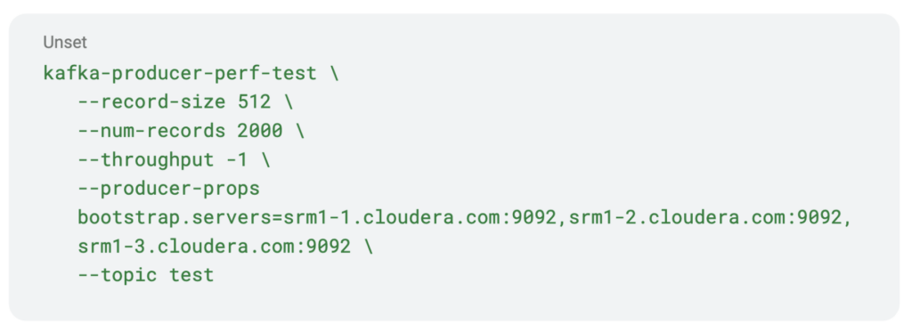

    Create a topic, produce some records
    Now that SRM setup is complete, you need to create one of your source topics and produce some data. This can be done using the kafka-producer-perf-test CLI tool.
    This tool creates the topic and produces the data in one go. The tool is available by default on all CDP clusters, and can be called directly by typing its name. No need to specify full paths.
    1. Using SSH, log in to one of your source cluster hosts.
    2. Create a topic and produce some data.
    Notice that the tool will produce 2000 records. This will be important later on when we verify replication on the SMM UI.

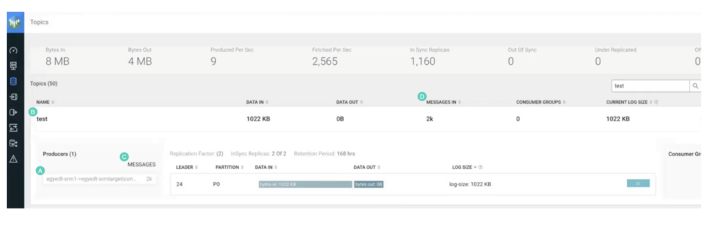

    In the next few steps, we will shift the focus to SMM to demonstrate how you can leverage its UI to gain insights into what is actually going on in your target cluster.
    How you can leverage its UI to gain insights into what is actually going on in your target cluster.
    Detailed Topic Information
    Notice the following:
    1. The name of the replication is included in the name of the producer that created the topic. The -> notation means replication. Therefore, the topic was created with replication.
    2. The topic name is the same as on the source cluster. Therefore, it was replicated with prefixless replication. It does not have the source cluster alias as a prefix.
    3. The producer wrote 2,000 records. This is the same amount of records that you produced in the source topic with kafka-producer-perf-test.
    4. “MESSAGES IN” shows 2,000 records. Again, the same amount that was originally produced.

    After successfully replicating data in a prefixless fashion, its time move forward and aggregate the data from the other source cluster. First you’ll need to set up the test topic in the second source cluster (srm2), as it doesn’t exist yet. This topic must have the exact same name and configurations as the one on the first source cluster (srm1).
    To do this, you need to run kafka-producer-perf-test again, but this time on a host of the srm2 cluster. Additionally, for bootstrap you’ll need to specify srm2 hosts.
    For bootstrap you’ll need to specify srm2 hosts
    Notice how only the bootstraps are different from the first command. This is crucial, the topics on the two clusters must be identical in name and configuration. Otherwise, the topic on the target cluster will constantly switch between two configuration states. Additionally, if the names do not match, aggregation will not happen.

    You can verify that aggregation has happened by having a look at the topic in the SMM UI.
    SMM UI
    The following indicates that aggregation has happened:
    1. There are now two producers instead of one. Both contain the name of the replication. Therefore, the topic is getting records from two replication sources.
    2. The topic name is still the same. Therefore, perfixless replication is still working.
    3. Both producers wrote 2,000 records each.
    4. “MESSAGES IN” shows 4,000 records.
